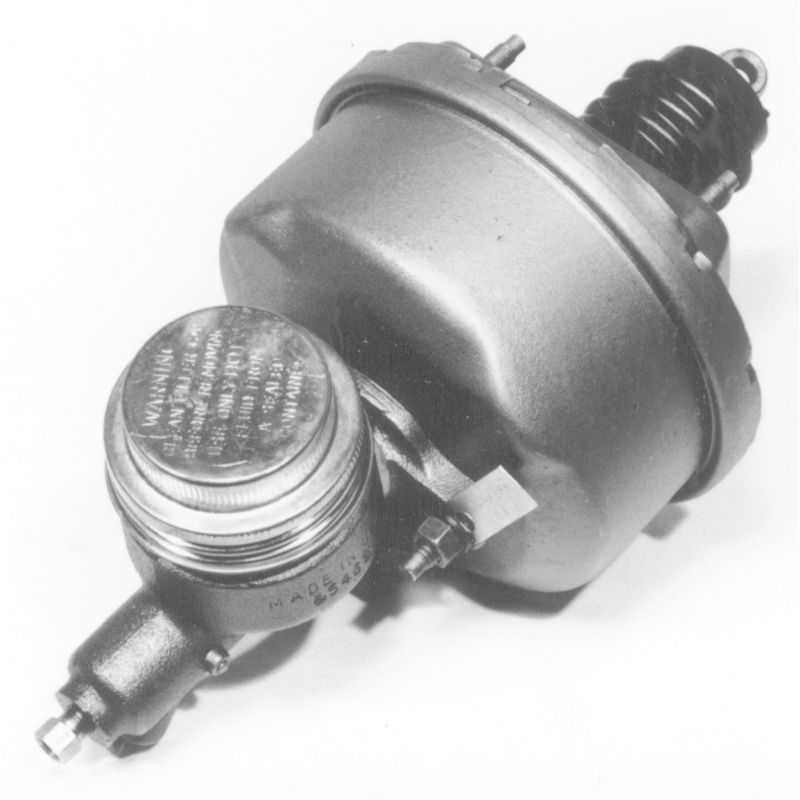

Im converting 65 Mustang 289 drum brakes to disc in the front. I bought a disc brake kit that was like this one but for v8 and bigger just like this!
http://lamustang.com/SQLCart/Images/Large/105274.jpg
I also bought a single bowl power booster master cylinder like this one.
http://static.johnsmustang.com/pictu...booster_al.jpg
I have a feeling I didnt quite get the right stuff, can someone help me by saying
1. What else I need
2. Does it need to be a dual bowl and if so can I still use the booster
Thanks abunch

No actual pictures or at least a brand name for the kit?
You should get a dual bowl MC for safety reasons. Most of them are matched with a different booster, assuming you have the stock one. Lots of guys use the manual kits with great results. I would consider replacing the lines if they are original though. Make sure to get a MC for disc/drum setup.
