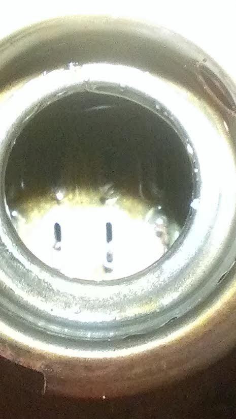

I got it. I have a history of over torquing things and turning simple projects into much harder ones so I'm a little gun shy...
This is all I can see inside the cap opening. If you ask me, it looks like a whole lot of rust clogging things up (which of course is what several of you said it was). Not sure if this answers the question of what kind of rad is in there though. I did look through the stack of paperwork my Mom sent with the car and saw nothing about a new radiator. I do have registration paperwork going back to the 60s though

so where's the water at?
How much would you have to add so it was 1/2" to 1" above the metal slats (cores)
There is water in the reservoir. The guy said the reason it almost overheated on the way to the shop was that it was low on fluid. I asked them to top it off so I could drive it home. Maybe he only checked the res? In general, this is a very reputable shop but I'm having my doubts...
To answer your question more directly though, I don't know. it is below that grate in the pic but I don't know how far below.
stop it...he's had a bad day.

I was being serious...If its just below the core say 1 qt then its okay but if its 3/4 gallon low then we must ask...where's it going!!
To the OP buy a gallon of distilled water and pour it in let me know how much it takes to get 1/2" above the "grate"

ok, how many rows do you see?
it looks like it is two rows deep.
the tubes are usa size so it is a usa made rad . . they do not make a 2 row high efficienct rad so it is a std rad.
there is likely a small raised date code on the top that says 64.
the rad i listed is all you will ever need . . simnce it is 450.00 and they were ggoing to charge you $550.00 to dsell you one and install it, the rad they were going to sell you was far inferior to this one.
i know, i was just trying to be entertaining, lol.
