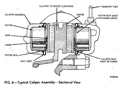

Assuming you have the 4 piston caliper used on '67's the caliper is not threaded the mounting plate is. You need a new mounting plate. On some model, Ford actually safety wired these bolts. The head of the bolt would have a hole in it. A thin steel wire went through the head of each bolt then wrapped around itself to keep the bolts from turning. The threads should have thread locker on them in any case.

I do have a 4 piston caliper. And it is definitely threaded.

I was wrong, the caliper is closest to me as I thread the bolt (away from center of the car toward the rotor and wheel).
After getting a new bolt and trying it, there is some thread on the mounting plate.
What I guess I need to figure out is do I try the hela coil on that mounting plate or try and replace the mounting plate. Not sure what is the best or the easiest.

what you are looking at is a caliper to spindle mounting bracket
find them in parts catalogs such as Mustang Unlimited ect.
