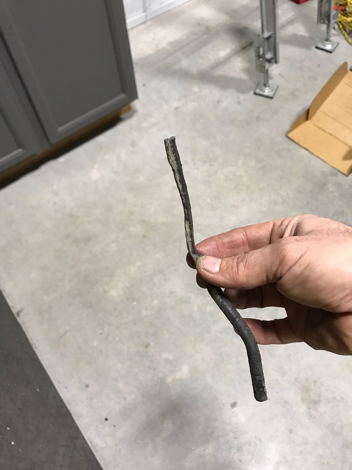

This is the crushed fuel line I found. I removed the section pictured and ran a temporary fuel hose until I install my EFI.
The fuel line was more than 80% blocked.
I am surprised the car even ran at all. But, damn does it run good now. Noticeable improvement in power off the line.
