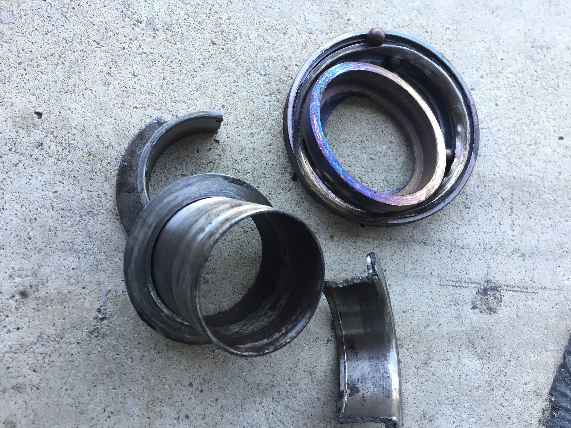

I think this was a centerforce TB. It lasted maybe 1.5 years maybe only a year. The TB that was in there before was replaced simply because I had the trans out and figured it was like 6 or 7 years old and should be swapped since I was right there.
I haven't pulled it out yet but bore scope images seem to indicate that it totally **** the bed.
What brand is best? Ford racing?

NTK bearings are pretty good, as are SKF.
Are you running a hydraulic clutch?

as for a replacement im not sure what I should exactly be looking for.
How do I know if a bearing is NTK?
Also the bearing needs to be "self centering" as in the face can slide independent of the collar. I installed a TOB in the past that was not self centering and it made awful sounds in which case I had to replace it again directly.

Timken was the other manufacturer I couldn't remember.
If you can't get your local auto parts supplier to tell you what's in the box, bearings are usually etched with the manufacturer and part number.
Is it possible the hydraulics are over-actuating the clutch? I've heard of issues with that.

I doubt it. Im wondering if they shipped this bearing with insufficient grease packed in it.
Im running just enough preload to allow it to shift into first. What I normally do is jack the rear wheels off the ground and if I put in the clutch and I can stop them from rotating by placing my hand on the sidewall I consider it good to go. Usually its just a bit tighter than the amount of preload it takes to keep the TOB against the diaphragm.

Wish you the best on the search for a good TOB gunjam. This is why I convinced myself to go with a hydraulic slave cylinder. I have been working on the bracket for a while now. When I am done you can bet I will post a thread to show everything. It seems like longevity is still an issue with hydraulic TOB.

I found one that came in an SKF box from napa...I'll give it a shot
