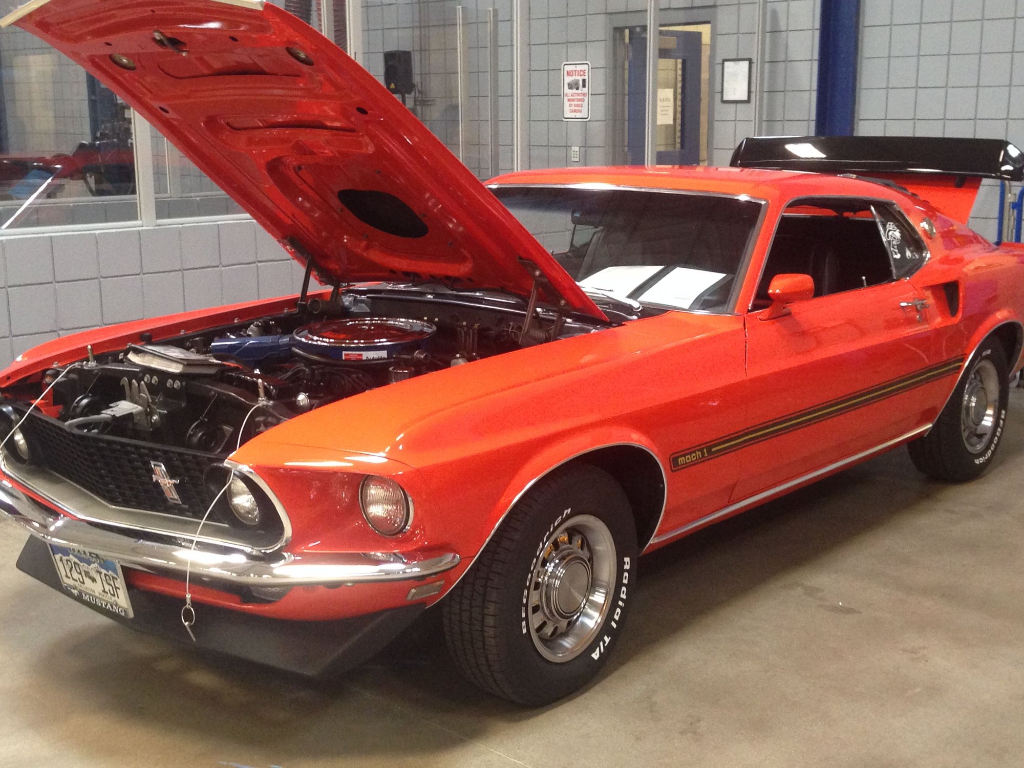

Wow.
One other thought: do you have a fan shroud, and if so, is the fan properly spaced in the shroud opening?

Yeah thats a nice looking mustang.
Fan shrouds are important for directing air through the radiator rather than allowing it run along the side.
