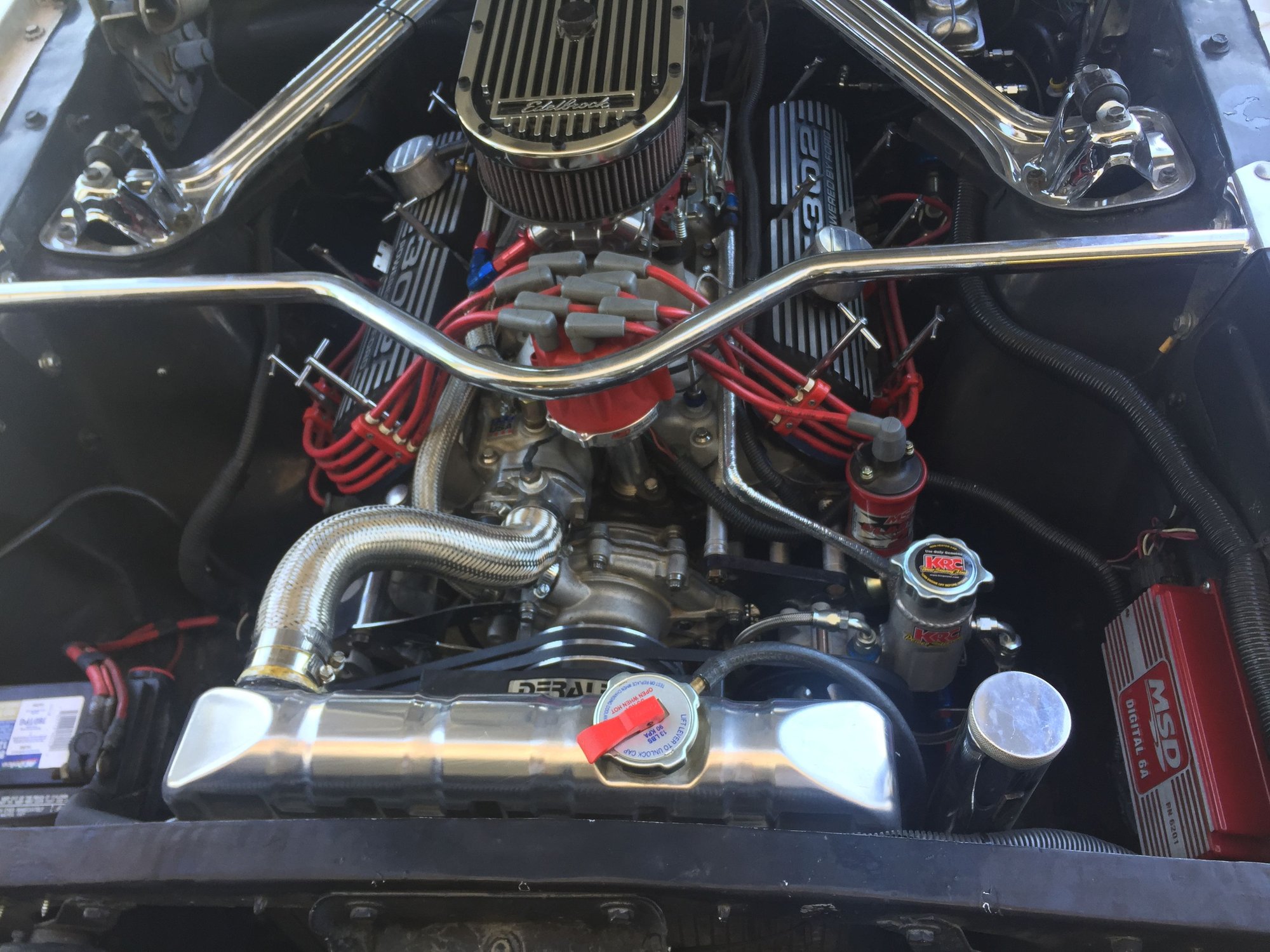

You should be able to embed a photo right here in the reply section. Just click that yellow hill and sun looking square thing at the top of the message window and then click browse device and select the photos you wish to share.
So did a quick comparison test on my 302 with electric fan and high efficiency U.S radiator Aluminum x flow.
I think the T stat is 185
ambient air was 102 (ir gun)
water temp was 184 from behind the Tstat measured with onboard Arber instruments sly-1612 accurate with in +- 0.10 degree in real time.
bottom hose was 149F (ir gun)
Fan controller was set to run near 100%....This is odd in my case because I use a PWM fan controller. it has infinite fan speed up to max RPM @ 13.8V so rather than it just coming on to 100% and shutting off it stays at a constant RPM to maintain a set temp (195) in my case....if temps creep up the fan follows as temps drop off the fan backs off very smoothly. I over rode this feature and set the fan to run about 90% power. I did this to test for max heat dissipation which forced temps below my set point (195) and caused Tstat to regulate temps.
The shaded driveway is much less abusive than a packed road. Incoming air temp was only 102. The blacktop in sunlight can run past 130 no problem out here plus the hot air being dump by surrounding car can easily increase incoming cooling air to many degrees above actual air temp in the shade. (weather station) In these types of conditions the fan usually runs flatout and still can't maintain much below 210f but in my driveway could easily dump 35degrees and keeps temps to Tstat regulation temps (185) I suspect when its running 213 the Tstat if fully open and water enter into radiator is 213f while I would guess water exit into engine is probably 200f (a 13 deg diff vs 35)
here's some pics of my setup
