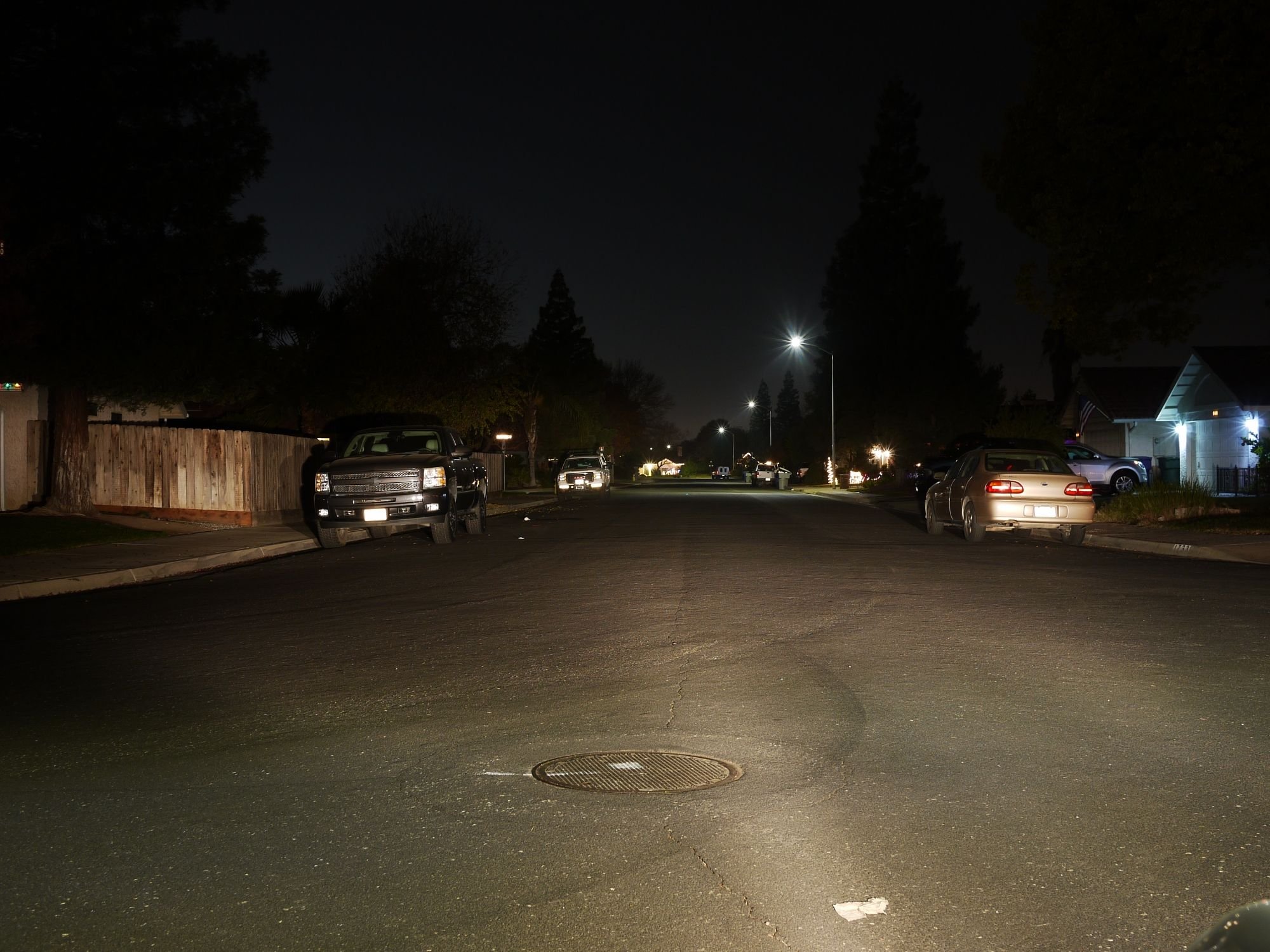

Because of the high price (about 800) for a set I figured I would take a bit of time and attempt as mostly scientific comparison with the best tools I have (a nice full manual camera) in an attempt to accurately compare one vs the other and attempt to accurately depict how they look in real life.
This is engine running, with alternator spooled to reg limit producing 13.8v indicated measured 13.4 at headlight plug. Stock Halogens, Low beam
Camera: ISO 100, F6.3, shutter 10 seconds, No exposure bias / bracket
Exactly the same as above but high beam.
This is a good to very good representation of color and light output as far as digital recreations of actual life events go. The light metering settings were picked to attempt to recreate a real life like image as it would appear if you were there....The result is not bad. Somethings in the distance may appear brighter than in real life due to the long shutter speed but its close

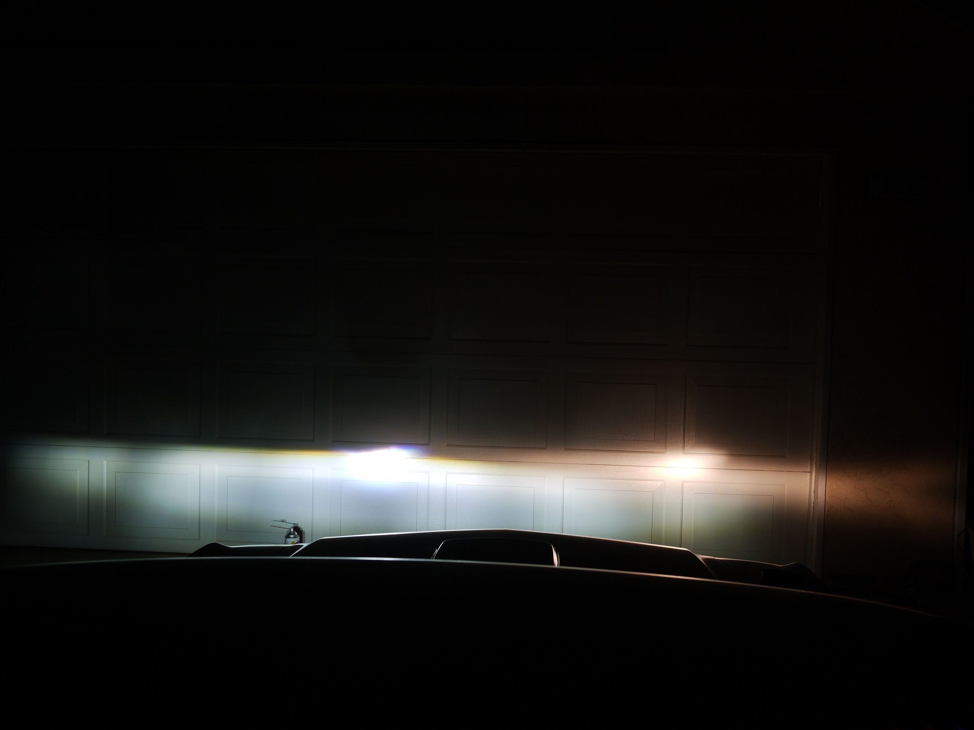

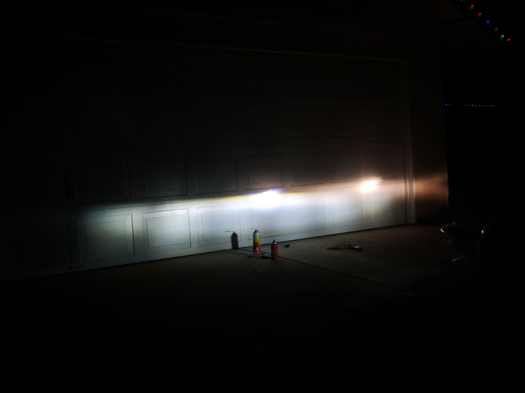

Engine not running at 11.4v shot dead center...This is a comparison of color between the two this is a very good representation of color. The LEDs are a very good white light very slightly blue. The garage door is white, This is low beam, The LED side is actually brighter than it appears by a small amount the center of the LED hotspot is over exposed and has pixel saturation (pixel is at max brightness value but true brightness is higher than its max value and cant be displayed) I should have set light metering for LED side and not halogen side but I was more concerned about showing color difference....It does a good job of that! Camera: F6.3, ISO 100, Shutter 1/10th sec

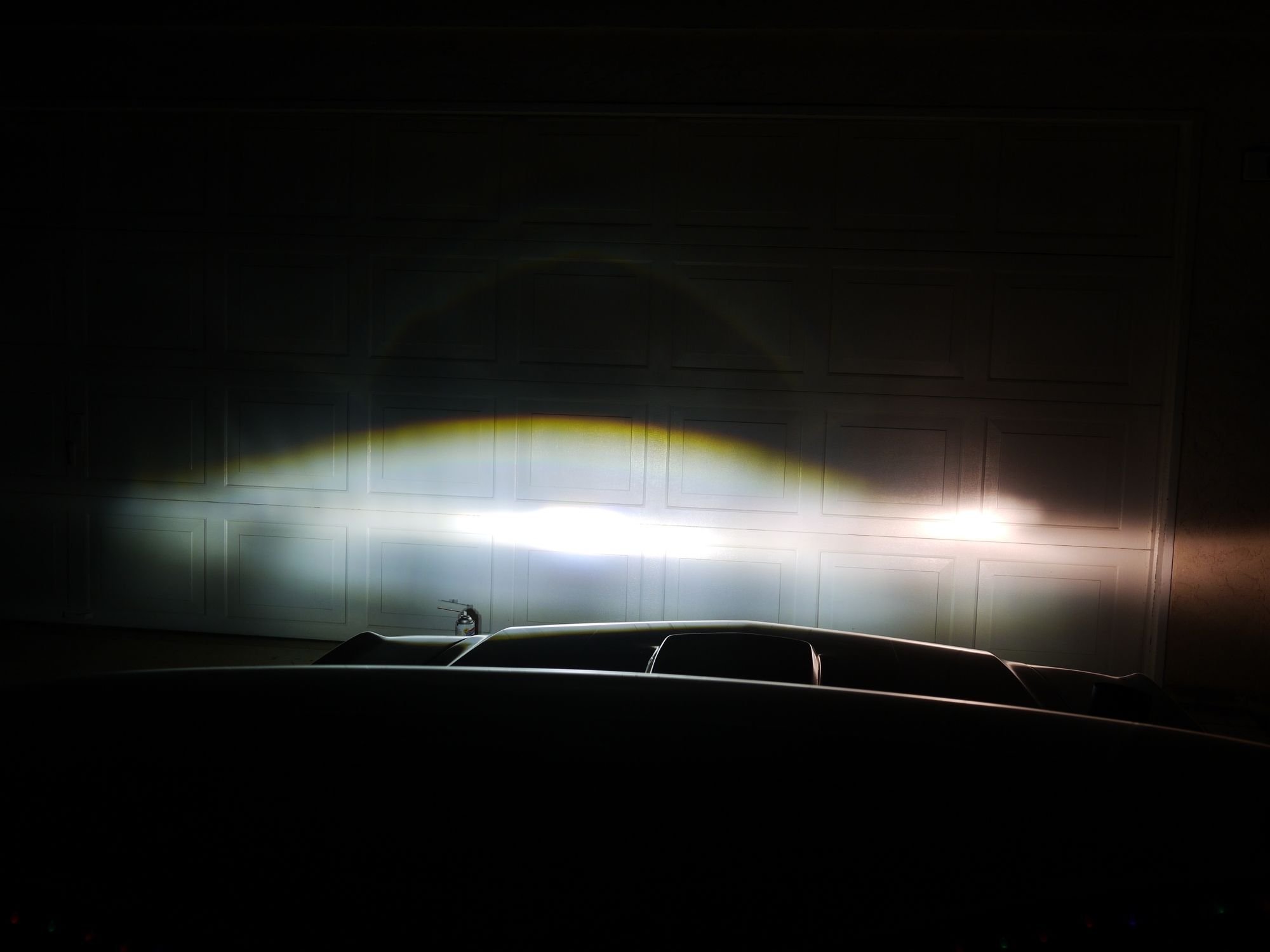

Same as above high beam

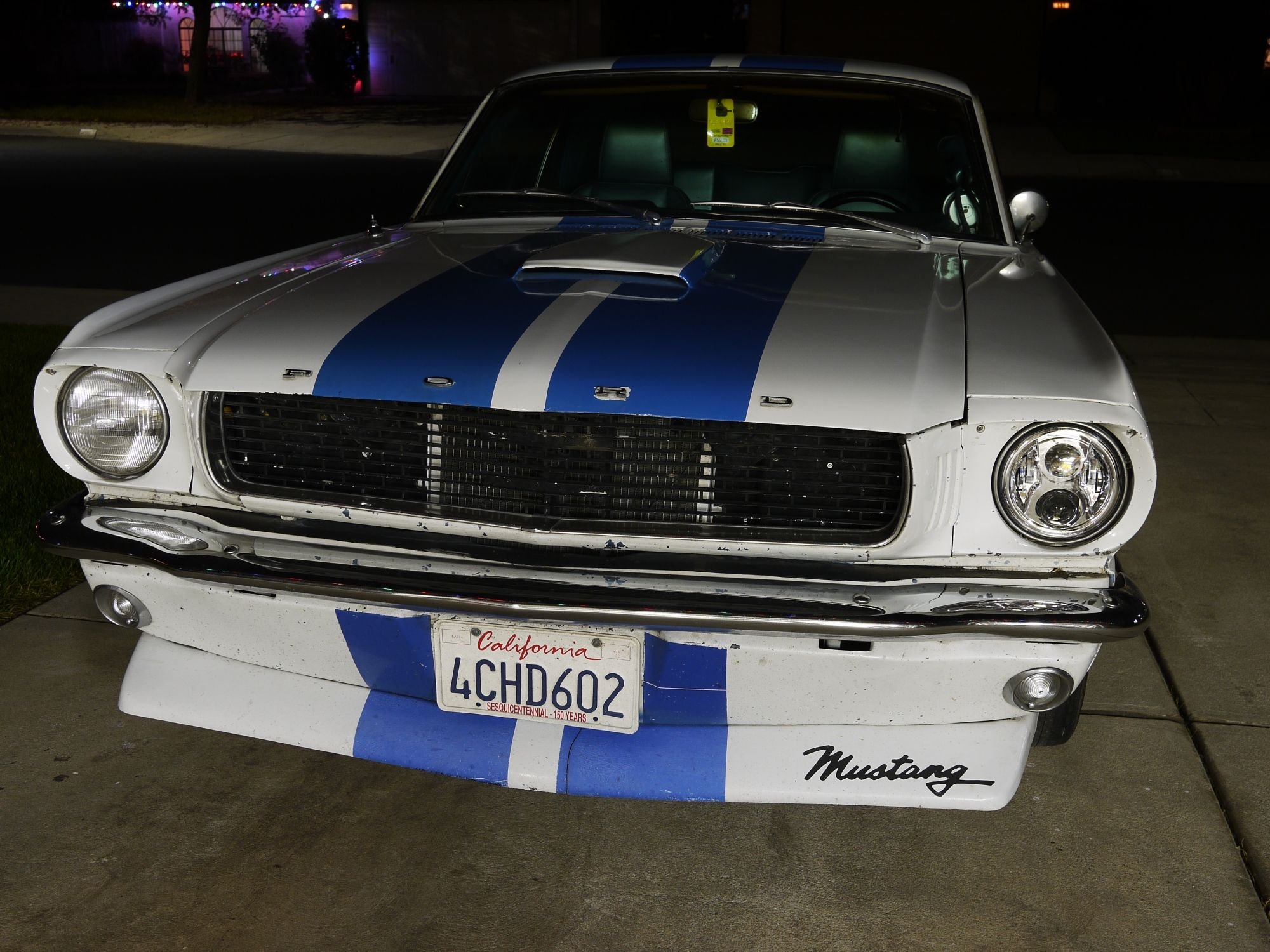

One of my concerns was the LED system might look distracting or out of place. They actually aren't too bad. They do come in black which I considered but rejected the idea as that likley would have been distracting and out of place...but If my car was dark or black in color I would have gone with back.
This is a head on color comparison the halogen looks a bit brighter because of its sloppy cutoff line bleeds more light onto the CCD.

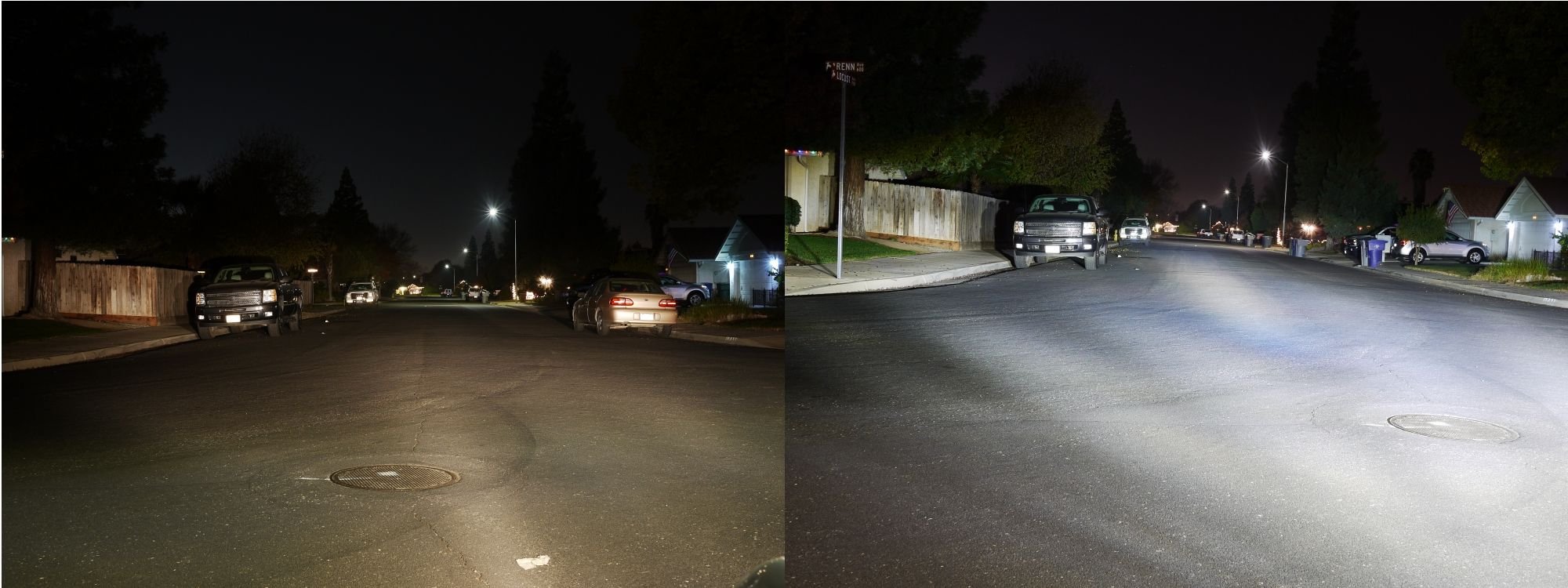

A now the comparison between the halogen and the LED on the same street. They are somewhat adjusted but not perfect all other conditions are nearly identical. This is with both LED headlights installed in the vehicle... The below image should be compared against image 1 (low beam halogen)

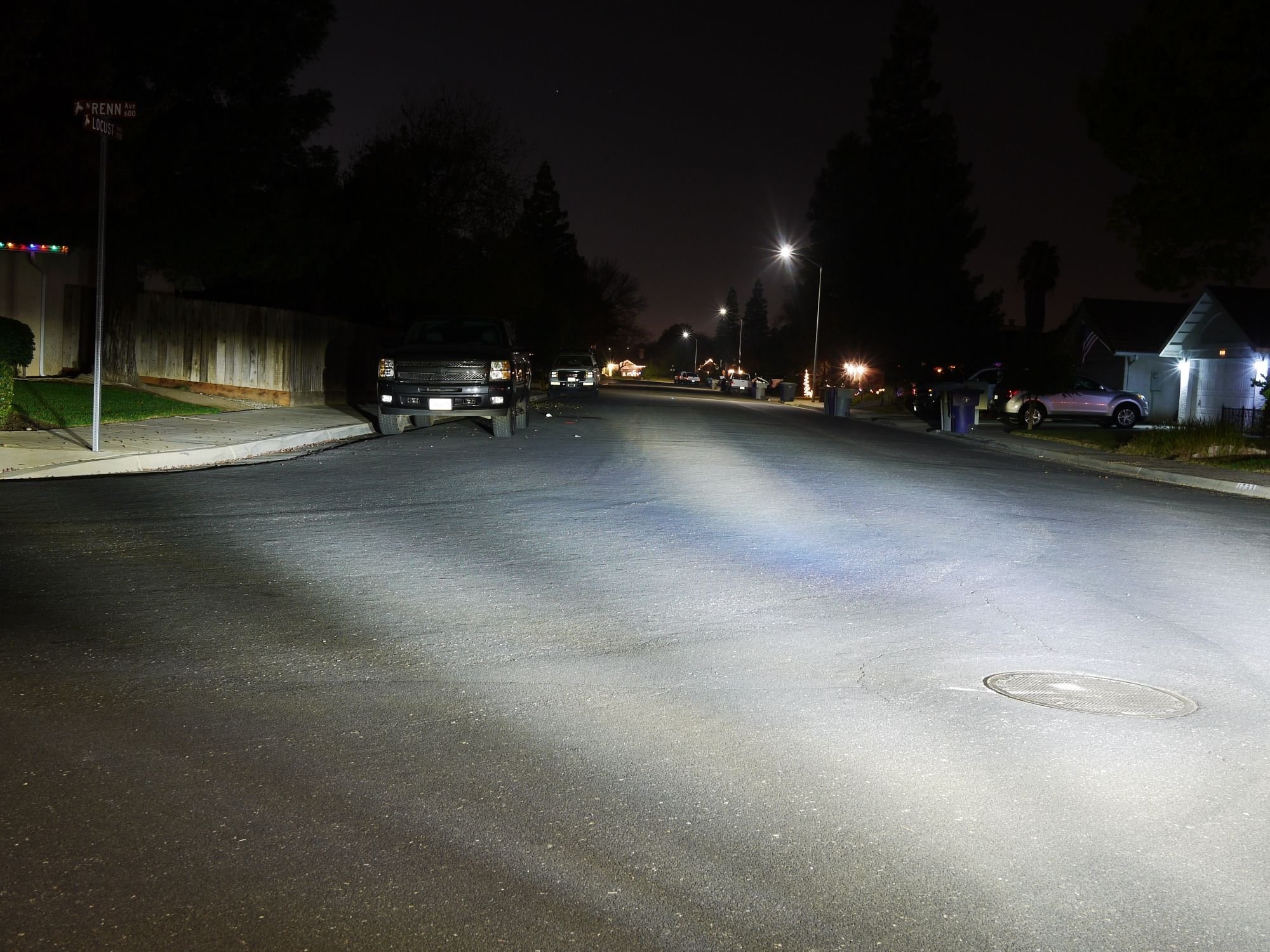

This is engine running, with alternator spooled to reg limit producing 13.8v indicated measured 13.4 at headlight plug. LEDs, Low beam
Camera: ISO 100, F6.3, shutter 10 seconds, No exposure bias / bracket Same as test with halogen (image 1)

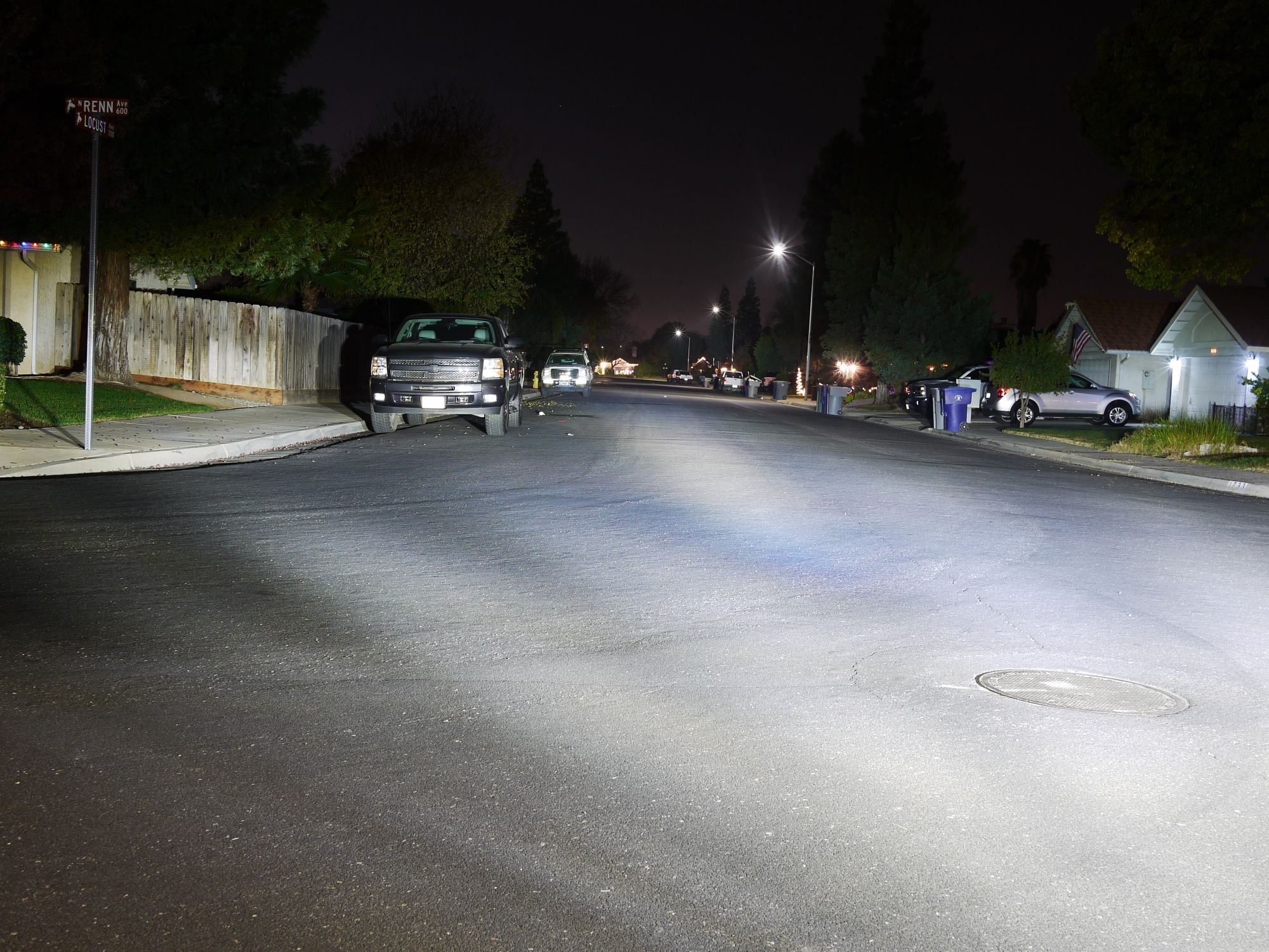

Exactly the same as above but high beam Also same as (Image 2)

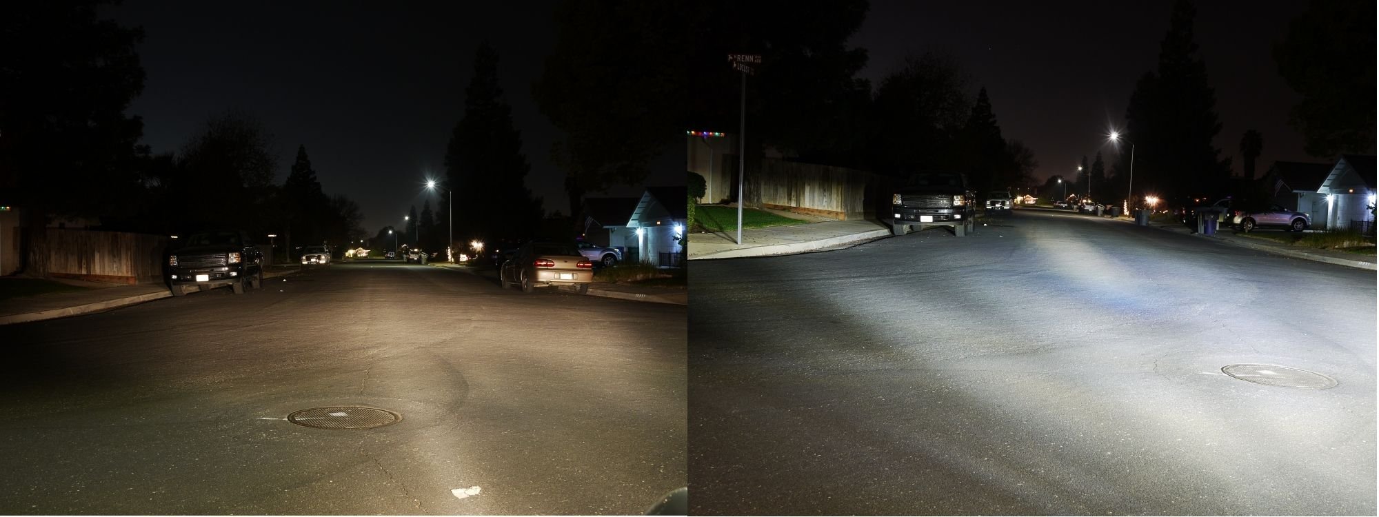

Low beam side by side for comparison... My dynamic enviroment changed a bit which slightly pisses me off from a comparison perspective but you get the idea...This is a pretty accurate depiction of light level increase if anything the LEDs look slightly brighter in real life I would say this is a 95% accurate depiction. Look at color change at x distance...Green is green with the LEDs distant objects are much easier to see...
High beam side by side...The lights from the LED look more evenly diffused on the pavement in real life as well this also could be due to road crown and the slight nose high attitude of the car as it was on uneven ground. When driving around I dont recall them looking blotchy at all once adjusted proper. Could be due to CCD exposure vs the human eye as well....But again overall this is a good representation of light output.
So far Im pretty happy with them im not at all upset about the price after driving with them for a few minutes on some back roads away from city lights...They are quite impressive. The lens is cool to the touch after running them vs warm to hot range on the halogens. On high beams it makes reading things like street names and speed limit signs very difficult as they are extremely bright and overexposed...switching to low beams makes them easy to read.
The amount of light that now illumines the edge of the road is the biggest improvement on both low and high beam. The width of this beam pattern is absolutely massive especially compared to the halogen.
