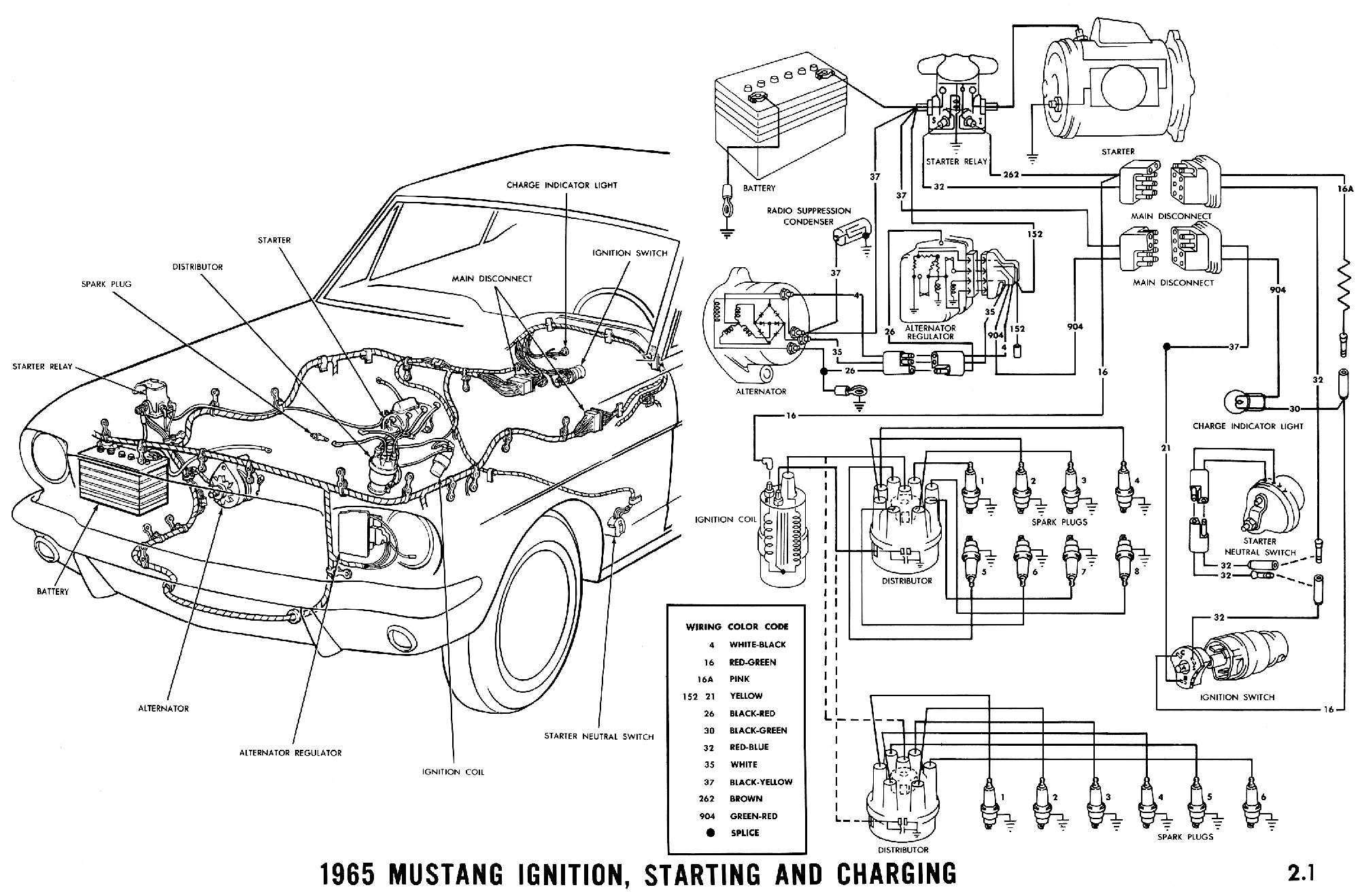

You are still getting ahead of yourself, though. Stop looking up parts and test what you have. Grab a multimeter and trace power flow from the battery to the starter. Test, don't guess.
