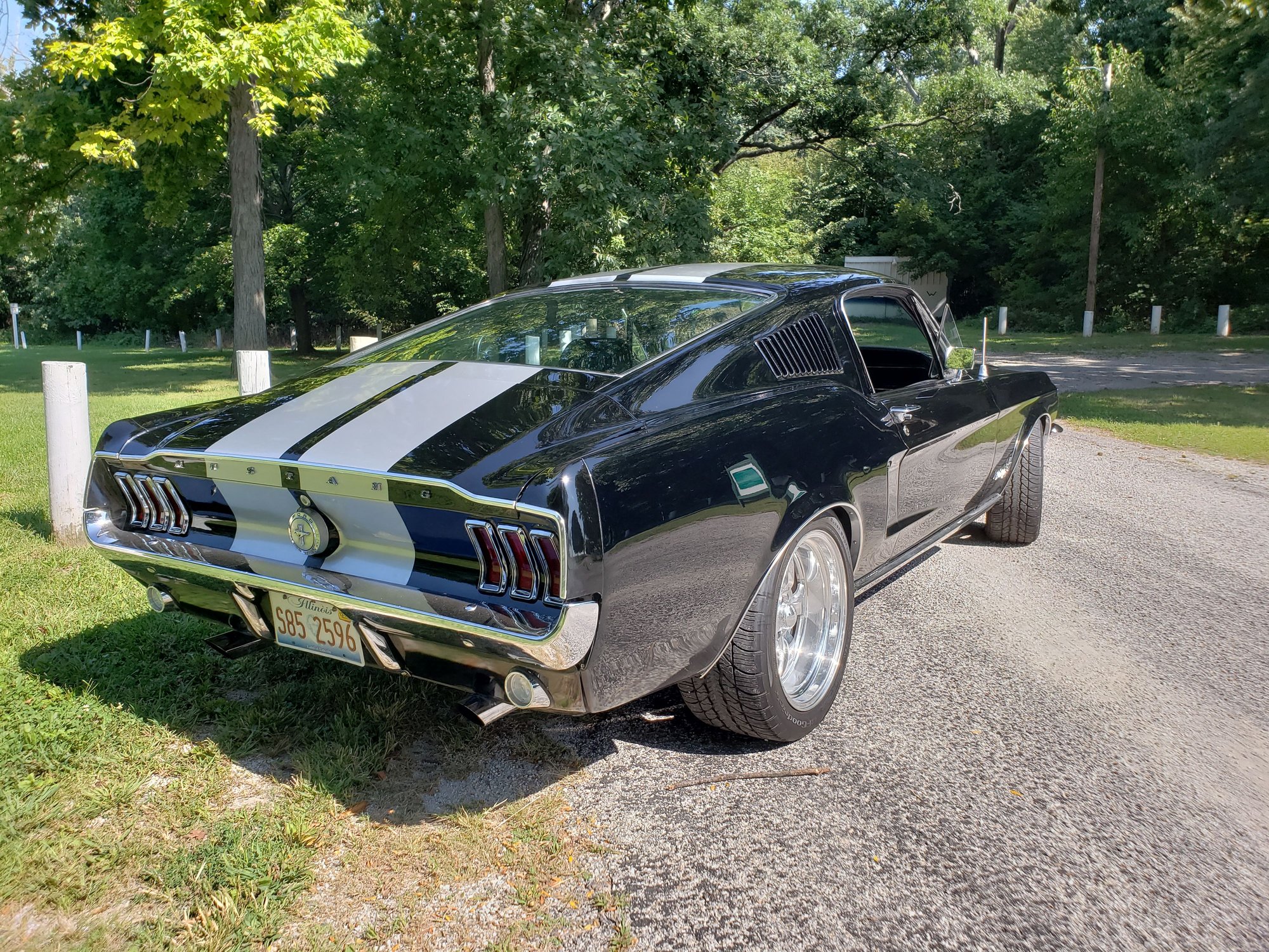

im looking into getting a 68 mustang fastback that was restored 2 owners prior with limited paperwork on the restoration. car looks mint and the current owner is being more than nice enough to answer any questions and help me with the process. the car was originally a 6cyl but was upgraded to a 351W by the last owner. supposedly everything was changed in the car including brand new wiring, transmission etc.

im having the car inspected by a local garage that specializes in fords but hes more of a mechanical guy. any recommendations as to how i can have the body/frame properly examined for rust/bondo? owner claims no prior accidents but carfax doesnt register prior to 1981.
