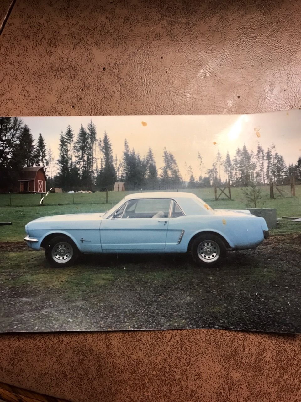

I was hoping to get help figuring out the color of this 64 1/2 mustang. I have a 67 that i want to paint this color for my aunt who had the pictured car when she grew up as a surprise to her. Any help would be appreciated

Hera ya go......these guys are REALLY GOOD!!
http://www.automotivetouchup.com/tou...64/all-models/

EDIT: Skylight blue should be the color

how do you know it is a 64 1/2?
64 1/2 = skylight blue ppg code 12850
65 = arcadian blue ditzler code 12854
