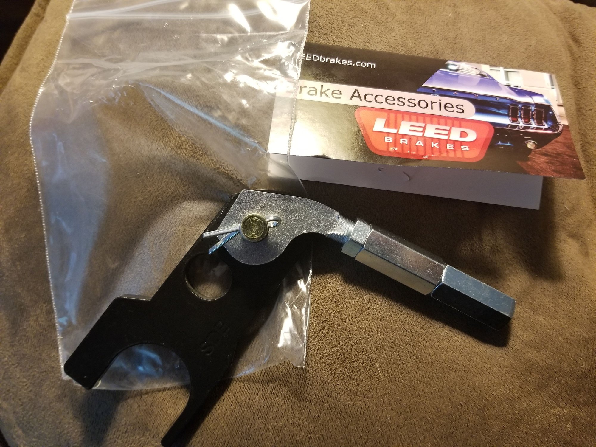

Has anyone ever used this brake pedal pushrod kit? I'm having issues getting a solid pedal so I contacted the company that made my master and booster (leed brakes) cause I thought maybe the master was bad and not holding pressure and the tech I talked to said it's a pedal ratio issue and is common on the 65-66 mustang and said I need this little pushrod kit that will correct the problem.
it changes where the pedal connects to the pushrod. I've seen a bunch of threads where guys were having my same problem but then they never finished the thread and said if they fixed it or not. This kit isnt on leeds site but I found it on cj pony parts and it says it's for manual disc only.
I have the same issue. Did adding this part help your pedal issue? I installed a kit with a booster too.
thank you.
