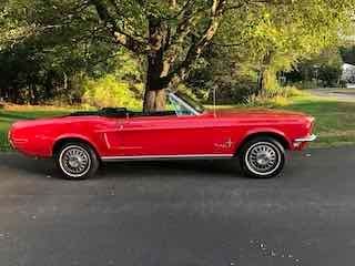

I bought a 68 Mustang convertible last fall. This is my first classic car since I was in high school 44 yrs ago. I had a '64 Nova and a '67 Camaro.
Just before I put it in storage for the winter, it developed a leak in the exhaust manifold. Now that I am working from home, and have some time on my hands, I am going to get it out of storage and start working on it. I plan to start by replacing the manifolds. Nothing fancy, 289 with dual exhaust. From what I can tell the rest of the exhaust is in good shape. Now for the age old question; The car is stock right now, with the original engine and transmission. Do I just replace the existing exhaust manifolds or do I improve by putting in headers, which will include modifying the existing exhaust system. I am taking a hard look at this because once I start improving, I can see myself wanting to go to disc breaks, a four barrel carb........ Keep it stock, or improve the ride. Pros and cons?

It is a convertible with an automatic transmission. I am looking for this car to be more of a cruiser, driven on weekends, between May and October. Sometimes to work on nice days. Not trying to turn it into a performance beast. I was thinking of front discs, some Craiger wheels and better tires for sure. I am torn between trying to retain the car as it was made or making it a little more comfortable, fun and safe to drive. I don't really care about resale.
