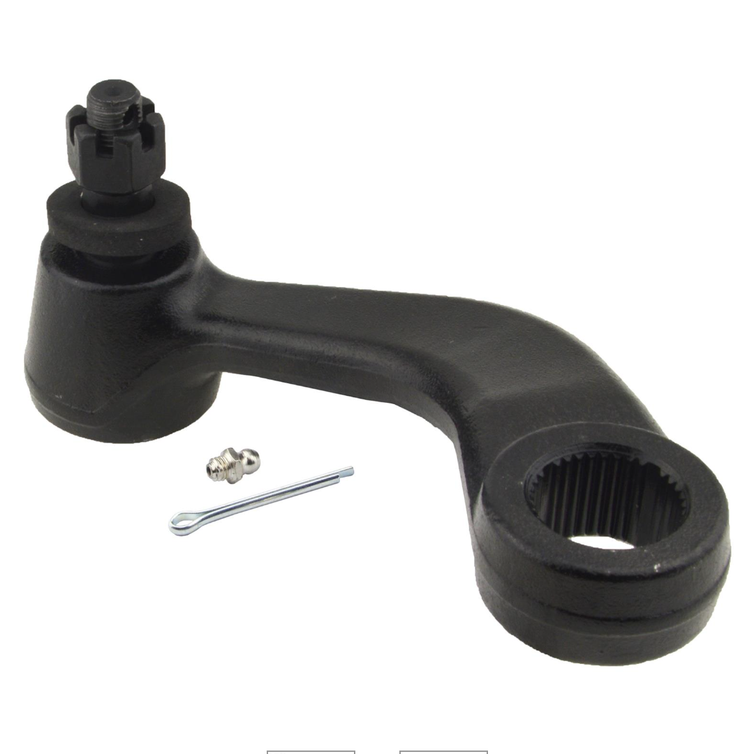

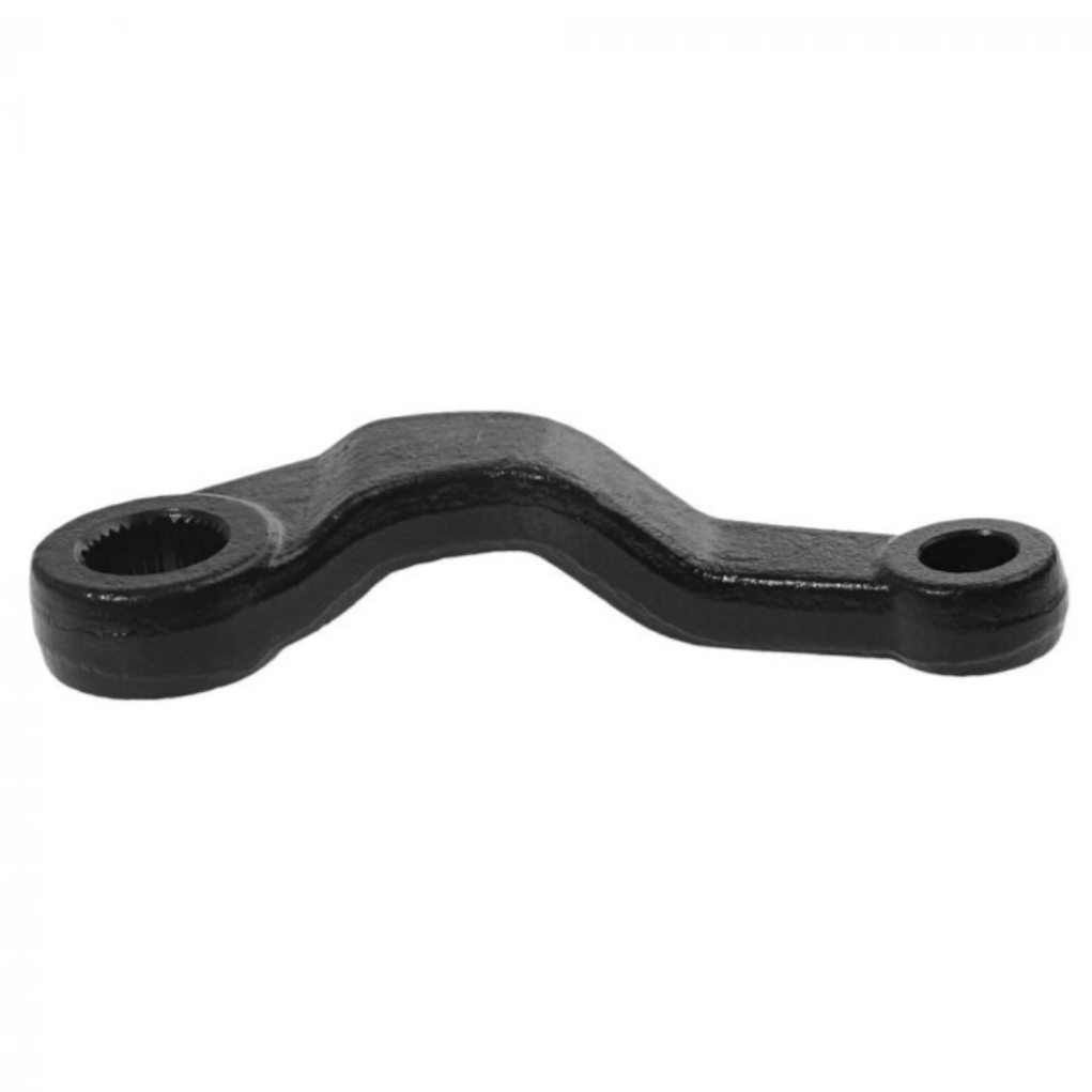

Hi, I have problems finding the correct manual steering linkage for my car. Early 67's built before January 5th had an 1 inch sector shaft like mine, after that date they switched to 1⅛.
When I look at vendors websites I find the correct pitman arm, it's the same as the 65-66 cars. I can't find the proper center link, idler arm or the tie rods.
The parts I see don't make a distinction between early and later 67 and it's easy to see that the center link doesn't work with an early 67 pitman arm.
The shop manual doesn't stipulates a difference.
Can someone help me with this?
Thanks!
Late 67 pitman arm with a sector shaft of 1⅛\" and similar to a 67 6 cyl 1" sector shaft.
Early 67 and 65-66 1" sector shaft pitman arm.
