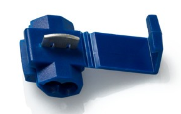

You will want at LEAST 2 Automotive electrical "Quick Splice" (usually found in blue) connectors. (I say at least 2 because you might drop one in a hole down there in the console.)
Quick Splice Connector for connecting a 3 wire to an existing circuit wire.

11. Now - the tricky part. You want to use those 3-way splice connectors to attach 1 each pigtail wire to A) The black wire from the emergency parking brake switch, and B) to the black and white stripped wire from the parking brake switch.
