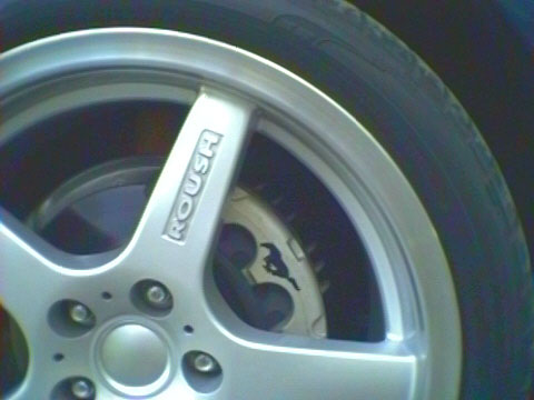

I painted my brake calipers a while back.
Just wanted to post some pictures, and report
on the two types of paint I used.
I used two products, three coats each:
G2 epoxy (red) on the caliper and Dupli-Color spray (Black) on the anchor plate.
The G2 results in a very smooth & glossy surface, while
Dupli-Color comes out more of a satin (although the cap looks glossy).
Both are holding up well. The G2 definitely looks much nicer,
however, I did notice a small chip on one side, so I wish I
had saved a small amount unmixed for touch-up.
Later touch-ups is one advantage of the spray has.
I created a stencil using the sticky part of a post-it note an x-acto knife,
and spayed the pony right over the dried G2.
I found I could only use the stencil once, so you would
either need to use a different material, or make one for each caliper.

Thanks for all the complements!
mustangmike06: While I painted all four calipers,
I only put the ponys on the front. It takes a lot of time.
I later found a company that makes decals and sells them for $8,
which appears to be a much easier way, but I don't know how they would hold up.
