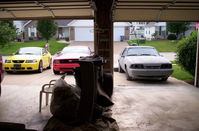

[IMG]local://upfiles/73430/4817ABCBD3FC42808A3EE66F0D341D23.jpg[/IMG]
Yeah, this is for expirence but also to save money and just something to do(I have a lot of free time...)
I've never really cared for silver fox bodies, to be honest. But what color mustang is that, Orange Crush? That's almost exactly what I was wanting. Maybe just a little more red, but not much.

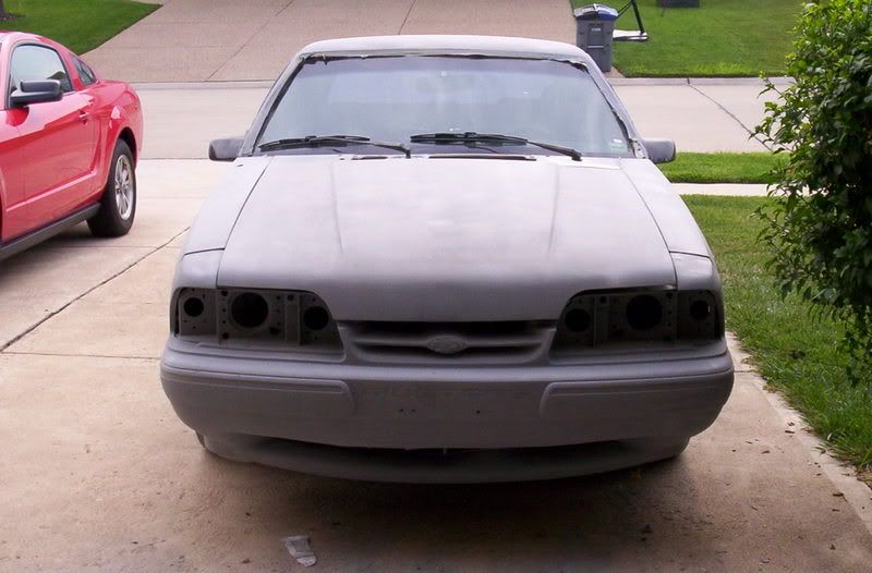

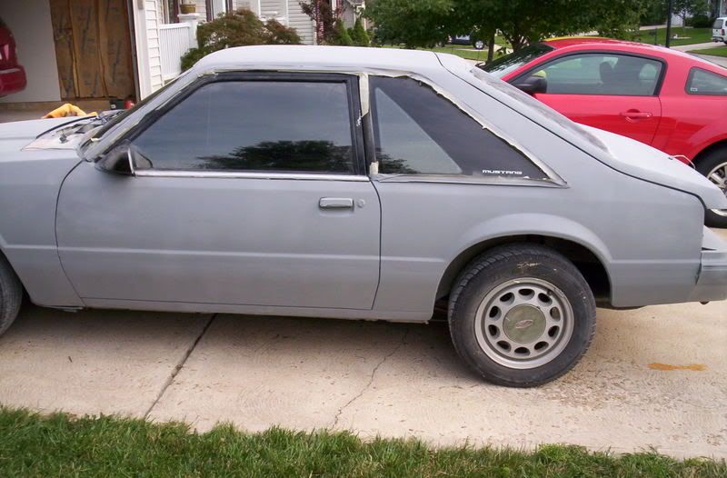

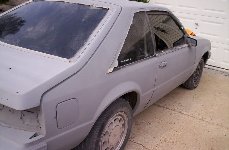

Here's what I have done so far
I wasn't going to put the molding back on, so what do you think I should do about the bumpers since they look like they have the molding on them?
