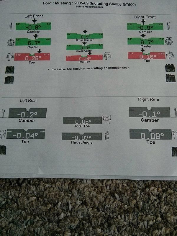

i got my second opinion this morning from another shop....they said the front end, tie rods, LCAs are all fine and adjusted the alignment for me.
here is the alignment report from fleet farm:
here's the one from sears auto this morning, (before on top, after on bottom)
IMO the car does seem to ride a lot smoother now, just glad i didn't have to replace LCA/tie rod.... hoping if i save up some money down the road i will one day treat myself to some asymmetrical all season michelin tires but otherwise car is running nice and smooth and quiet right now not surprised, i noticed it seemed like a quiet day at fleet farm and they wanted use the guy with a mustang as a cash cow :S
