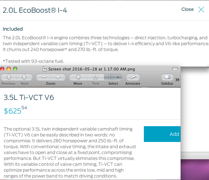

Yes, yes, it's been discussed before, but opinions where all over the place.... so after all the discussion on Ecoboost versus V6 what is the consensus of those who "really" understand the technology on which is better "in stock form" for a transportation car.
I ask because I'm getting ready to order a new Ford Edge for my wife & there was a concern of the Ecoboost having valve & intake problems that require expensive cleaning down the road. The Ecoboost will give the best mileage, but mileage is not a major concern since we are retired, while the V6 seems to be a more tried & true engine design than the Ecoboost technology. In the Ford Edge the V6 cost about $625. more than the standard Ecoboost which might pay for any cleaning of valves, etc. down the road.
So for a simple transportation car..... Ecoboost I-4, or V-6?
Note Ecoboost H.P. is based on 93 octane.

Jim, how many miles on the Ecoboost? I know about the technology. I had an F150 V-6 Ecoboost & it was amazing towing a trailer without of the weight of a diesel engine. I'm thinking the $625 I save is there if the valves, etc. need cleaning down the road as some say. I wonder if the "oil separators" some put on Mustangs would help avoid that? Maybe it's not a problem.

as for the intake build-up concerns, I don't think it's nearly as big an issue on Ford engines as it was on older VW/Audi models. All DI engines (diesels too) will get some degree of deposits, thanks to the lack of fuel being sprayed directly into the intake port. But the borescope pics I've seen from a couple of Ford engines has been mostly some "fuzzy" gunk on the valve neck. This would be primarily due to the oil used to lubricate the valve guides. The VW/Audi engines which had horrendously gunked up intake ports had insufficient separators/"catch cans" in the PCV system. so all of that oil mist being sucked into the intake was just caked all over the ports.
in short, I think it's something which exists but isn't likely to be anything you'll need to worry about.
