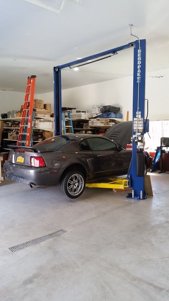

Old May 29, 2016 | 11:16 AM
TTWISTED's Avatar
TTWISTED
Joined: May 2016
From: NEW YORK
Well, this morning I guess I answered my own question. As surprised as I was to see it, it appears the passenger side turbo has failed / failing seals. Plenty of oil inside the intercooler. Appears to be shaft play in both. So, without knowing a ton about turbos, I'm going to investigate rebuilding as I don't have the coin for two new ones.
That being said, I'm open to any input / suggestions anyone has for this process. Based on Hellion Power Systems website, these appear to be Turbonetics units and I want to say T3 or T4 models. I'll update the post as I progress. Wish me luck.
