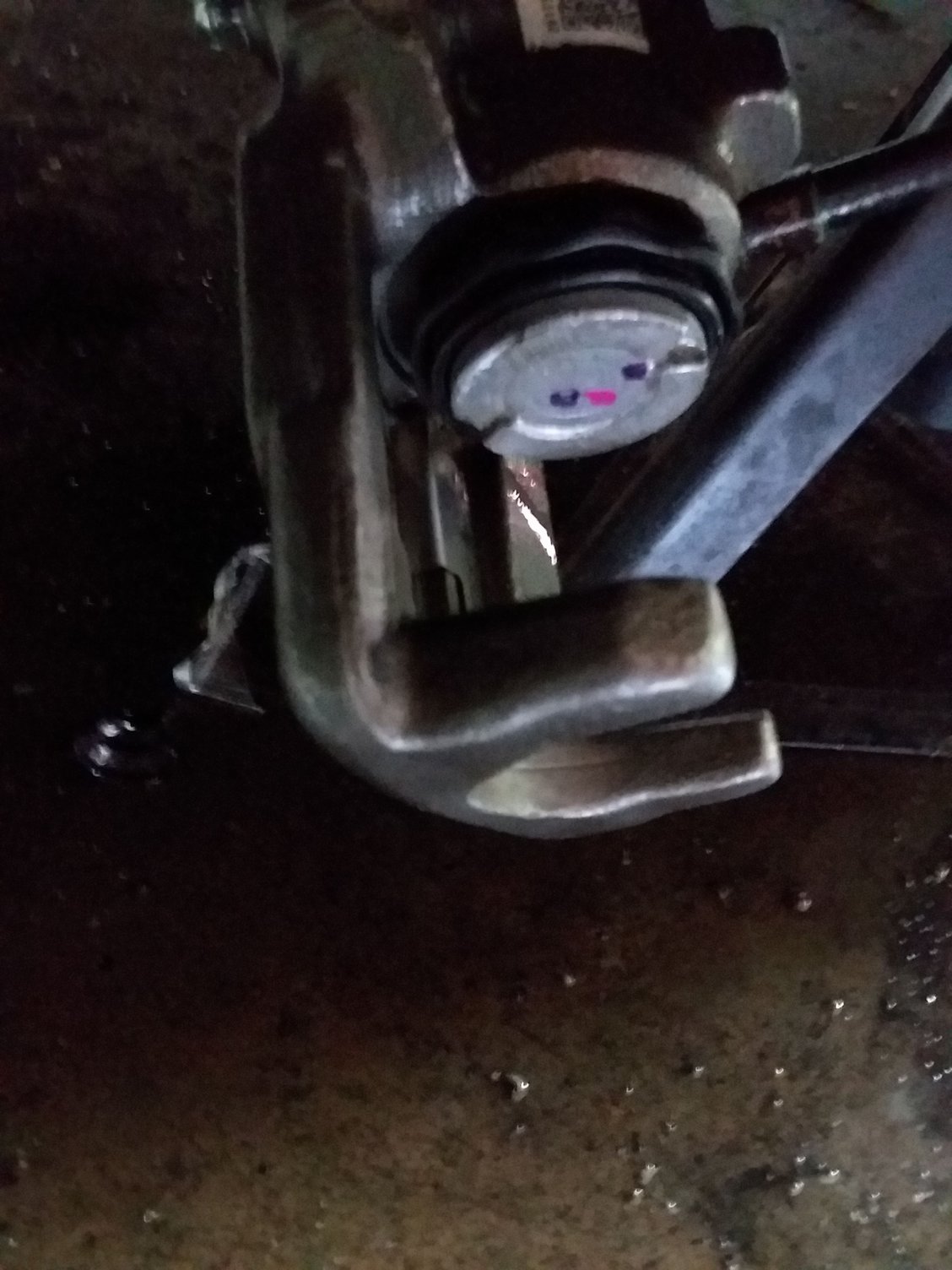

I have a 2000 mustang I just replaced the rear brakes and calipers. Now it keeps blowing the seals on the passenger side caliper

Is it the piston seal that keeps blowing out? Or is it leaking from somewhere else, like the banjo bolt washers?

First the seal around the ebrake shaft blew out l thought maybe a bad caliper so I took it back swapped for a new caliper. When I installed it the seal on the piston blew out this time.

is the other side closing when you apply the brakes?
The rears have screw like pistons don't they?

Not sure what you mean by screw like piston but here is a pic. as far as the other side closing I'll have to wait till I have someone to watch it for me

isn't there another seal on the inside of that piston? I think it'll unscrew completely...IIRC from my other car. There was an inner o-ring in there.
