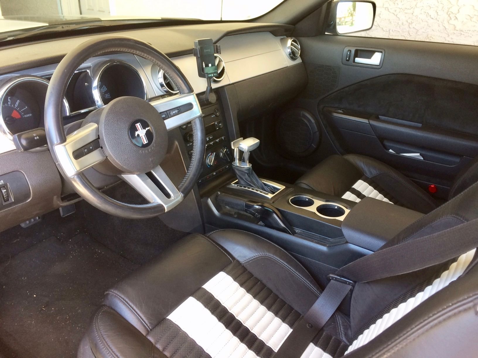

Hey guy I've got to replace the multifunction turn signal / bright light switch in my 07 GT and I'm wondering if anyone can give me the heads up on how involved a job it is ?

Hi Heres why I think its the stalk, arm lever choose your term when I pull back on it to turn on my bright lights the switch won't lock into place. The bright lights come on but I have to hold the lever back to keep them on.
