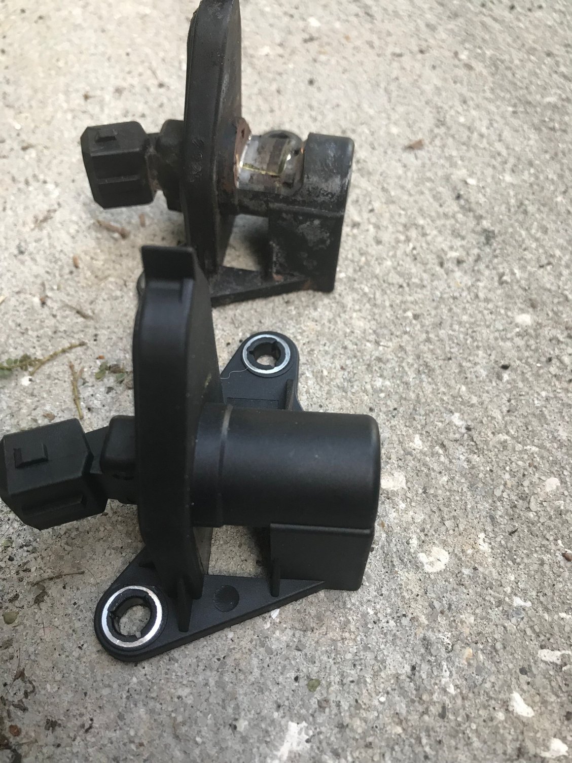

Thanks mustang dude, i appreciate your time to reply and assist in my stang issue. I have a new development, when I pulled my crankshaft sensor I noticed the crank pulley was grinding into the sensor. The pulley looks to have moved almost 1/2” in towards the block. Because of where the sensor sits between the crank pulley and the block it was ground down until it stopped responding. I assume now I need to replace the crank shaft pulley and Harmonic balancer to fix the issue?

Yeah, I don't know what would cause the pulley to make contact with the sensor.
I would think the sensor was loose, and hitting the crank. Put the new sensor
on, tighten it down and see if the crank is hitting the sensor. You would not be
able to install it if the pulley was in the way...

There is definitely no room for the sensor to be installed. The original was not loose at all.

You're gonna need a new harmonic balancer then. What happens is, with the heat,
if the layers separate or slip, the timing marks shift and thus throw off the placement
of the timing marks. This will make it difficult, if not impossible to time the engine. So,
yeah, even with a new sensor, the timing marks would be off. Not only that, yours
moved inward. You should be able to see that, the crank pulley will be more dished inward.
Also, if the the rubber layer in the harmonic balancer dries or wears out, it can cause the entire
harmonic balancer to completely fail by separating. If the harmonic balancer separates,
the engine belts will usually come off and the vehicle will be left without engine accessories.
Since you're going to need a new crank pulley, and if you have the extra money, get an
underdrive pulley. That will reduce the accessory pulleys parasitic loss, and get a little
more power to the wheels. It does not ADD horse power, and TQ, it increases WHP,
while BHP remains the same.
