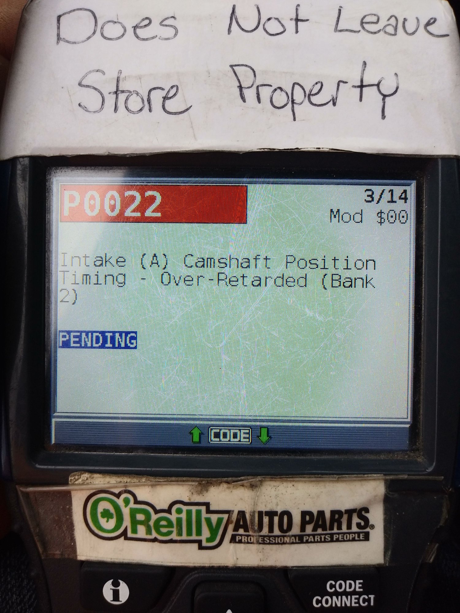

Just bought 2010 gt its throwing these codes
05-09 GTs usually throw a camshaft code p0022 when the alternator starts going out. One or more bad diodes in the rectifier throw a bunch of electrical noise into the electrical system which affects the signal wire for the cam sensor that messes up the sensors sine wave.
2010 gts have the identical engine but the alternator is different. Still it’s worth checking out. If you don’t have access to an (oscillo)scope for checking the sine wave I would recommend taking it to the dealer or auto electric shop and pay the diag fee. That way you either determine that’s the issue so you can fix it yourself or, find out what the issue is to save your wallet from the parts canon.
a bad cam signal throws the timing off which can affect the A/F ration and run the engine either rich or lean.
also, that p0100 means the codes were erased very recently and the computer hasnt completed a drive cycle. Let me guess, the check engine light wasn’t on when you bought the car? If not, the person who sold it to you reset it just before they sold it to you.....
Yes they said they were takeing care of the check engine light so I believe your right they just erased the codes that aint cool im takeing it in today and get it checked out they said they replaced a camshaft before i bought it and sometimes it has a sound like a lifter or sometbing knocking against the valve cover but then the noise goes away. Also is it normal for it not want to run at full power until 2000 rpm it feels like a delay in power until you get over 2000rpm im assuming thats due to the timing retardation?
