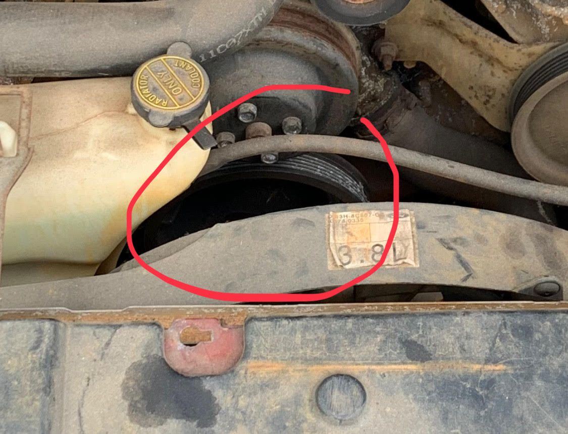

My main question is where exactly is the crankshaft bolt on this engine. I cant really tell through YouTube or photos. If someone can point me in the right direction on where the bolt is and how to access it that would be really helpful!

As far as the crankshaft nut, it is on the bottom pulley of the engine but I would plan on it being the worst case scenario and the engine is junked.

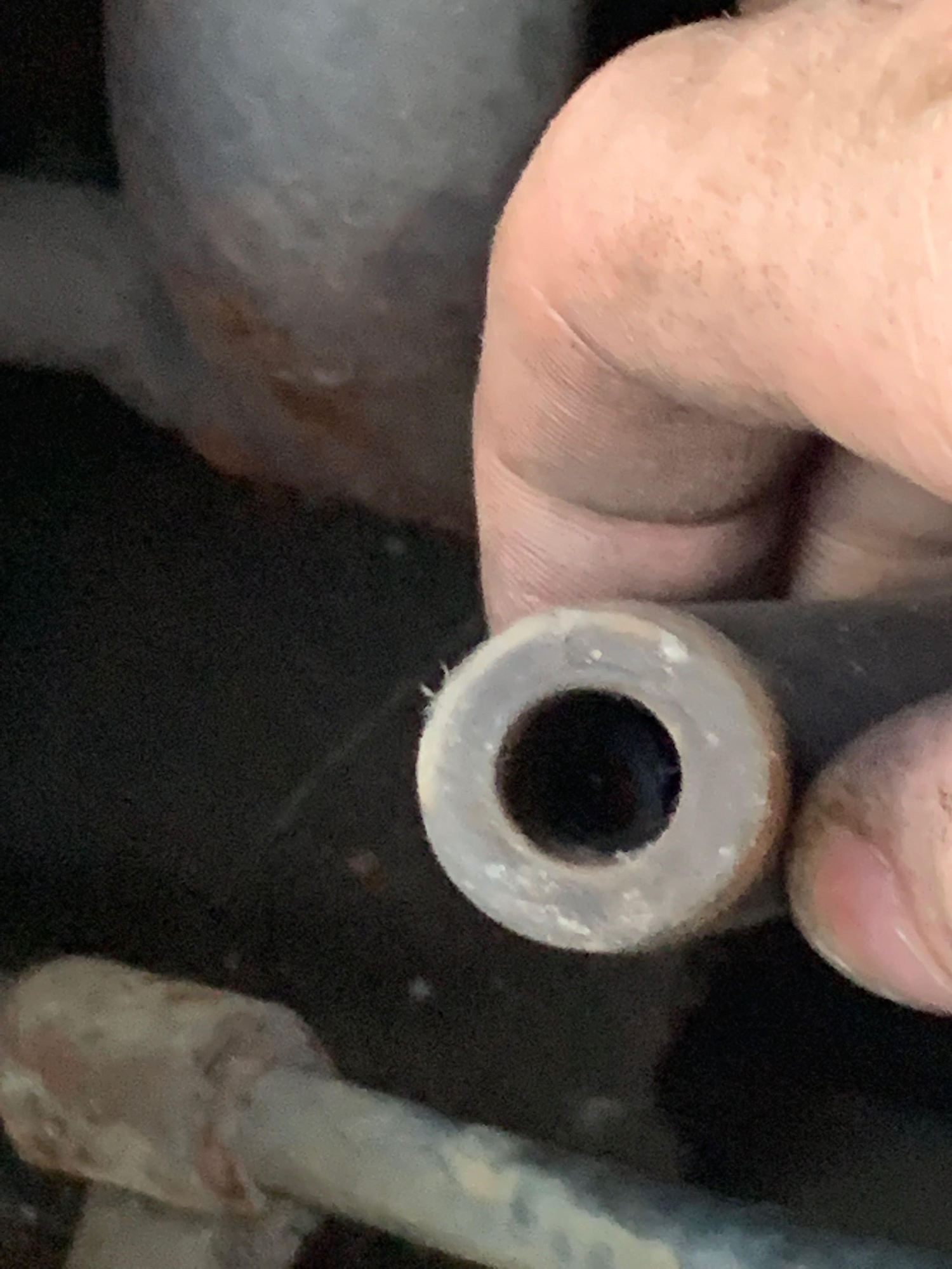

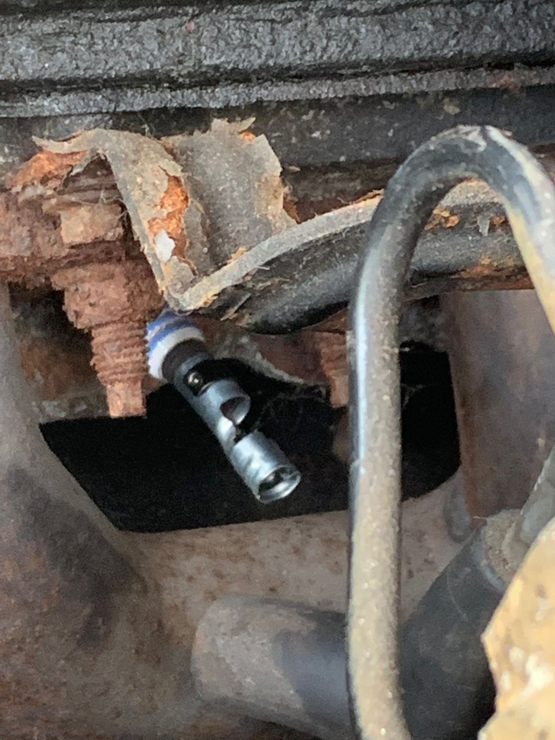

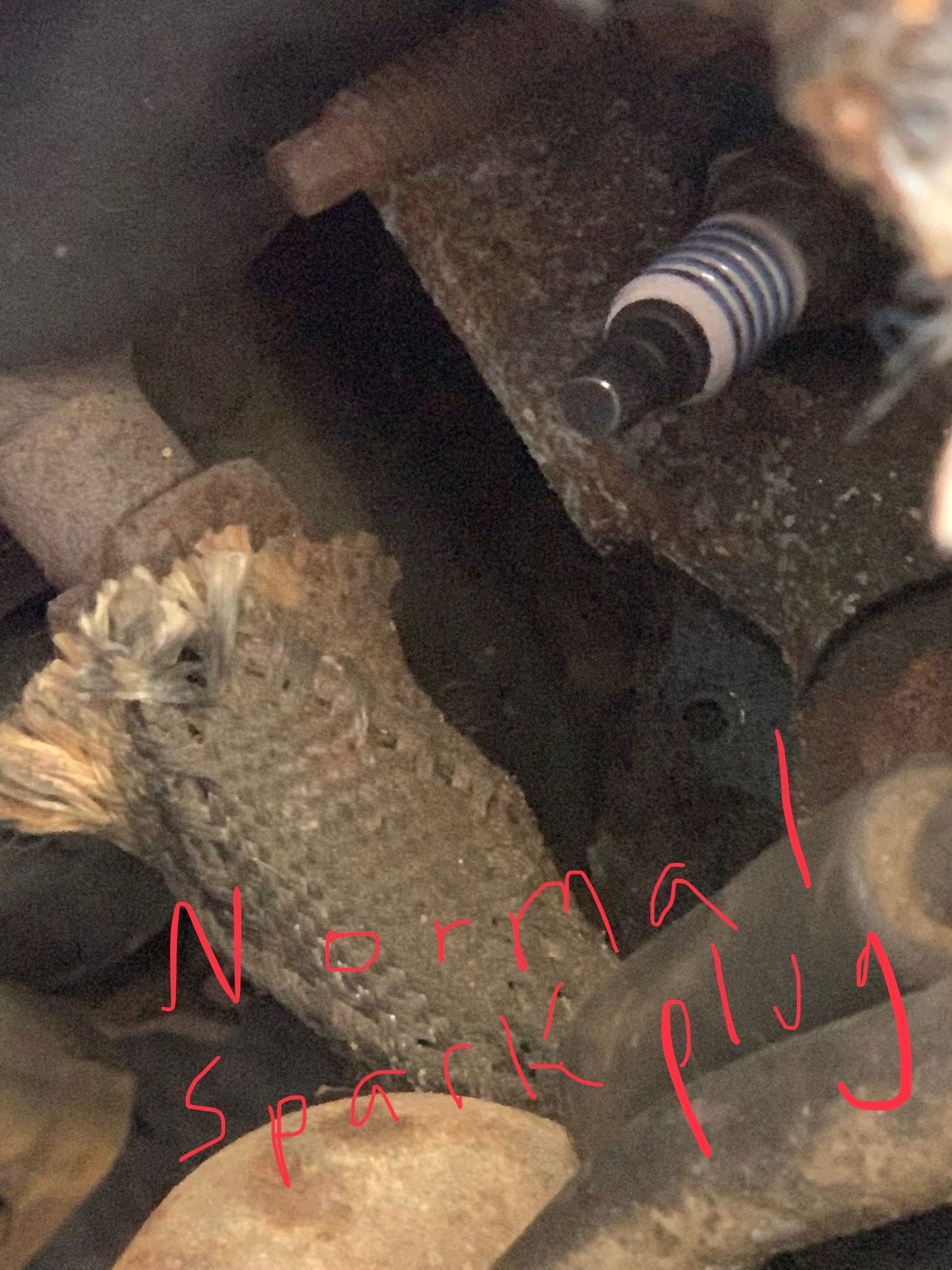

1. After pulling the covers on the spark plugs 2 of them came out with the metal from the inside of the tube still stuck on top of the spark plug. any way to salvage this? Photos attached.

Ehh..you're kind of hosed there but it's only a mouse turd to leap over. You can trim the wire back and basically rebuild the connection but I usually go with the path of least resistance. Buy a new set and be done with it.

1. 80% Sure I should be turning the crank by hand clockwise. To the right basically. Correct?
2. I THINK I got the crankshaft nut moving a bit after using a breaker bar. now the spindle thing where the belt would go. If you imagine where the bolt is in the middle - that ring on the outside....
When I turn the crankshaft bolt I dont see anything else moving. Is this a problem? I figured turning the bolt would make it move so I might be completely mistaken.
Now I had wiggled it a little to the left - counter clockwise... When I did that it almost felt like the nut was getting very loose. Is that ok?
