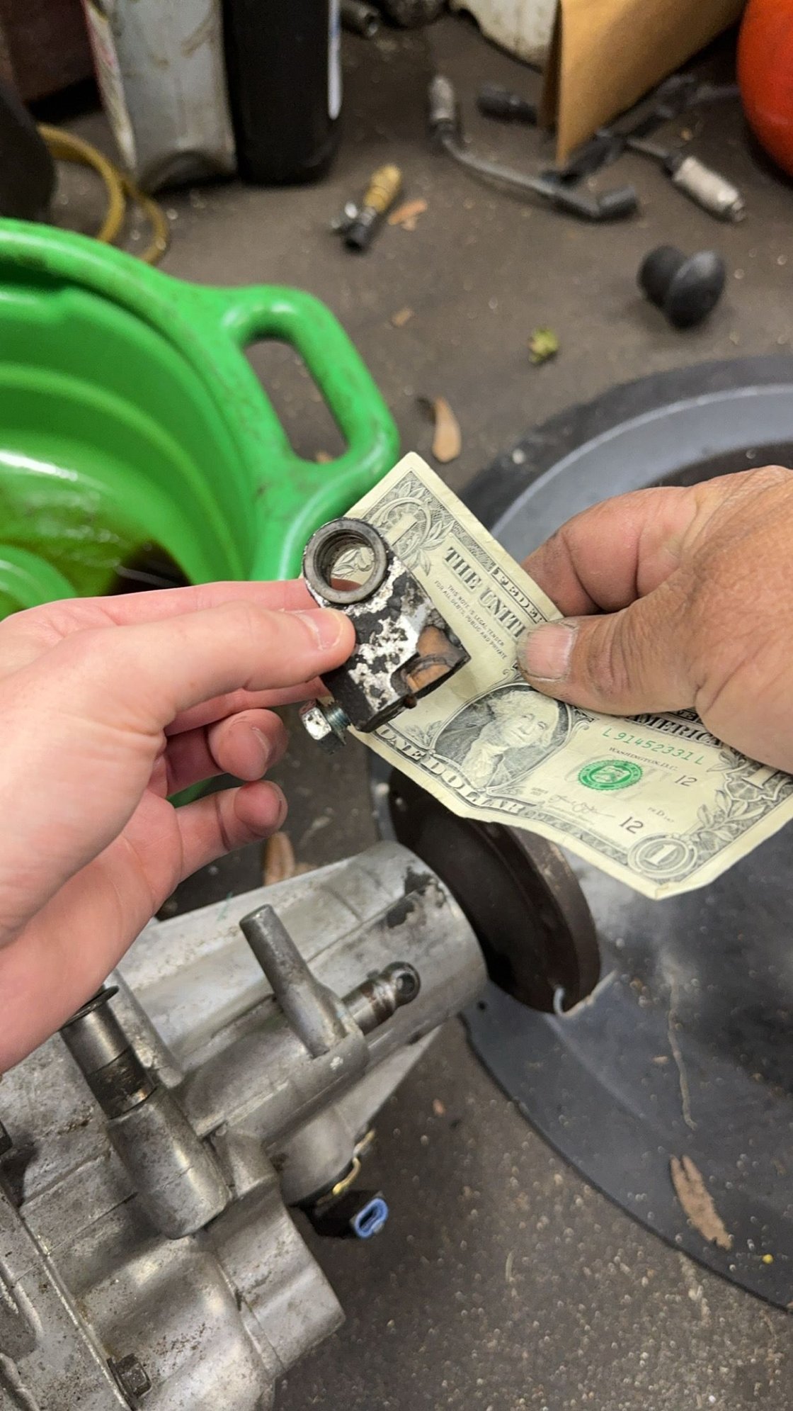

I’ve looked everywhere for this part and I cannot find it anywhere. It’s a shifter linkage I’m pretty sure for a 2005 Mustang GT manual transmission. Can someone please tell me what this part is called and maybe a link to where I can buy one.

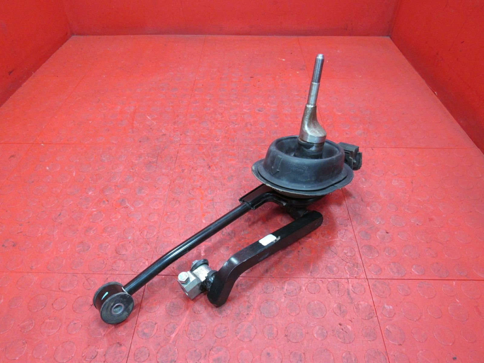

Ford Only Serviced This With a Complete Shifter. So You Would Need To Either Buy a New Shifter, Complete Used Shifter {Where a Lot Of Folks Leave This Piece On Trans So You Have to Check Picture if Ebay Etc.}
2005-2010 Mustang GT Shifters Should All Be The Same For The Most Part.
I Will Provide a Link to Some Mustang Specialty Wrecking Yards You Can Check With As Well!
Kc
Here is One Listed on Ebay. You Would Have To Make Sure They Pulled The Piece You Need as Shifter is Still on Car! I Would Send Pic and Ask if They Will Include This Piece For Sure!
