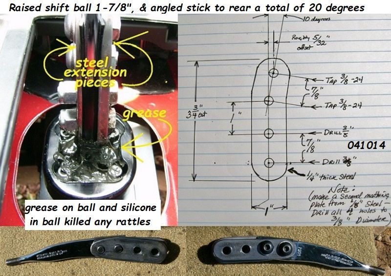

My Hurst Billet did exactly that when new. It was made loose for easy shifting. Was play in the ball that it pivots by like I see in your video, if you pull straight up & down, you feel it. I took the **** off, then the two boots, put a hand full of grey Ford Disc Brake Wheel Bearing grease on top of the recess with the ball in it, slipped a piece of plastic bag over it to keep it off the boots, then put the inner and dress boots on. Lastly, I put some silicone in the shifter ****, threaded it down and locked it with the nut. No more noise. In short time, use, it pulled grease into the socket.
My shifter wears an extension, why it looks funny. Raised the **** 1-7/8 inches. The thicker one is 1/4" steel, the thinner one is 1/8" steel. Still way shorter than OEM and not notchy. Got my elbow above the console lid edge too.
