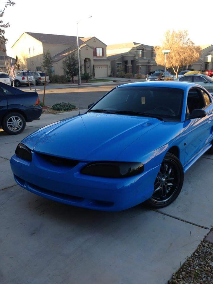

I have a 1998 mustang V6 I've had since I was a teen, and I've been thinking of doing a motor swap.
I got ahold of a 2009 Ford Crown Victoria P71 complete and running, now the question is if anybody has done a P71 swap for an Sn95 V6, and if so what would I be looking for to be able to complete the swap?
