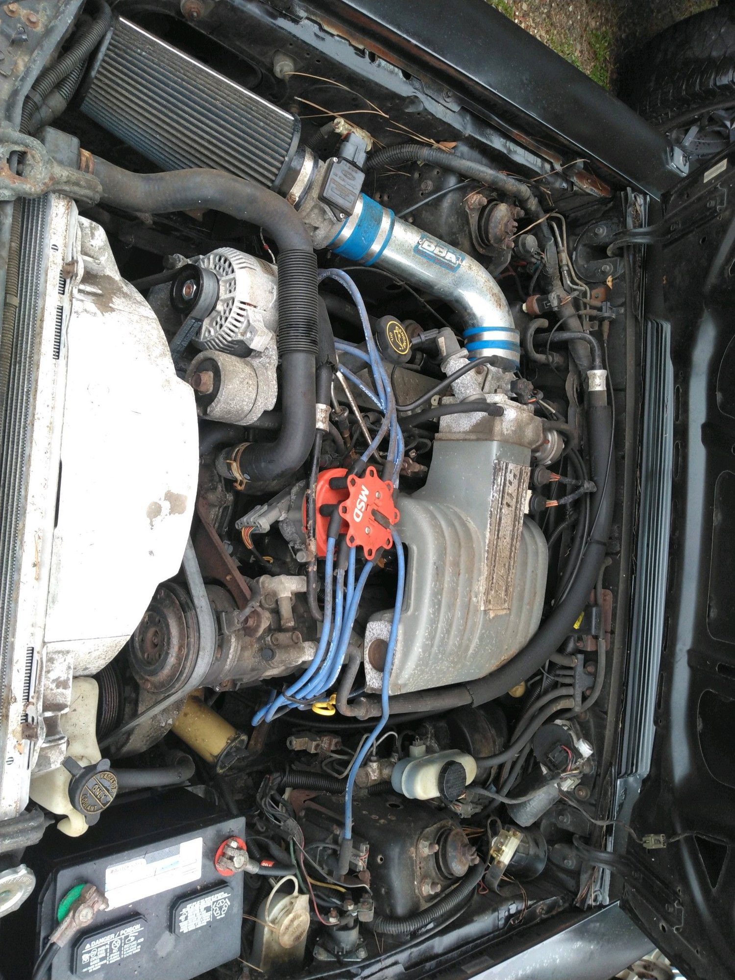

I need help not bs. I was givin a smashed 88 5.0 complete car. I want to put the motor and trans into my 04 v6. What will I need other then The donor car.
