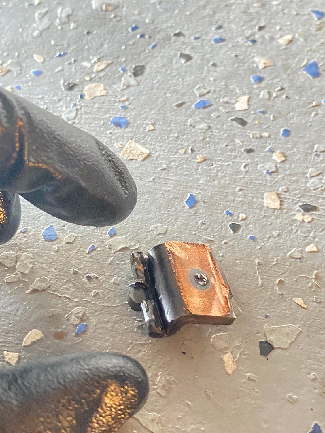

I’ve got the reverse servo out (and the filter.) servo piston was very dirty. All clean now!

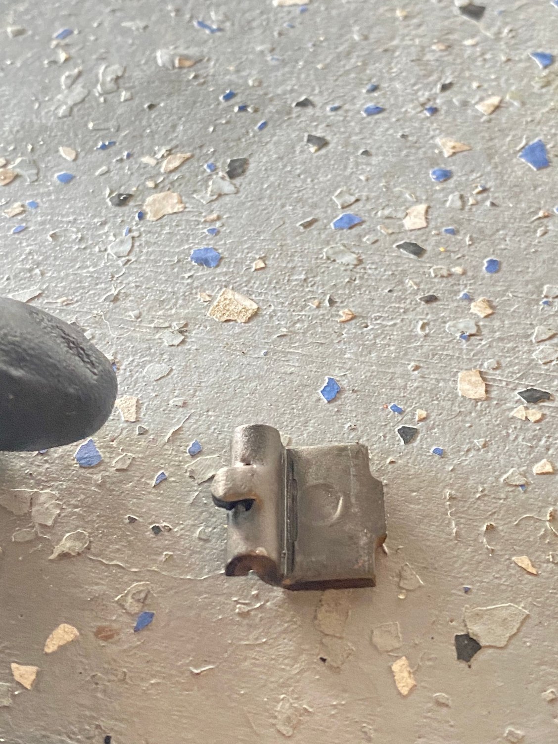

BUT, I found this broken metal piece in the pan.
please advise
This was on the magnet. The magnet didn’t have any other metal, just gunk.

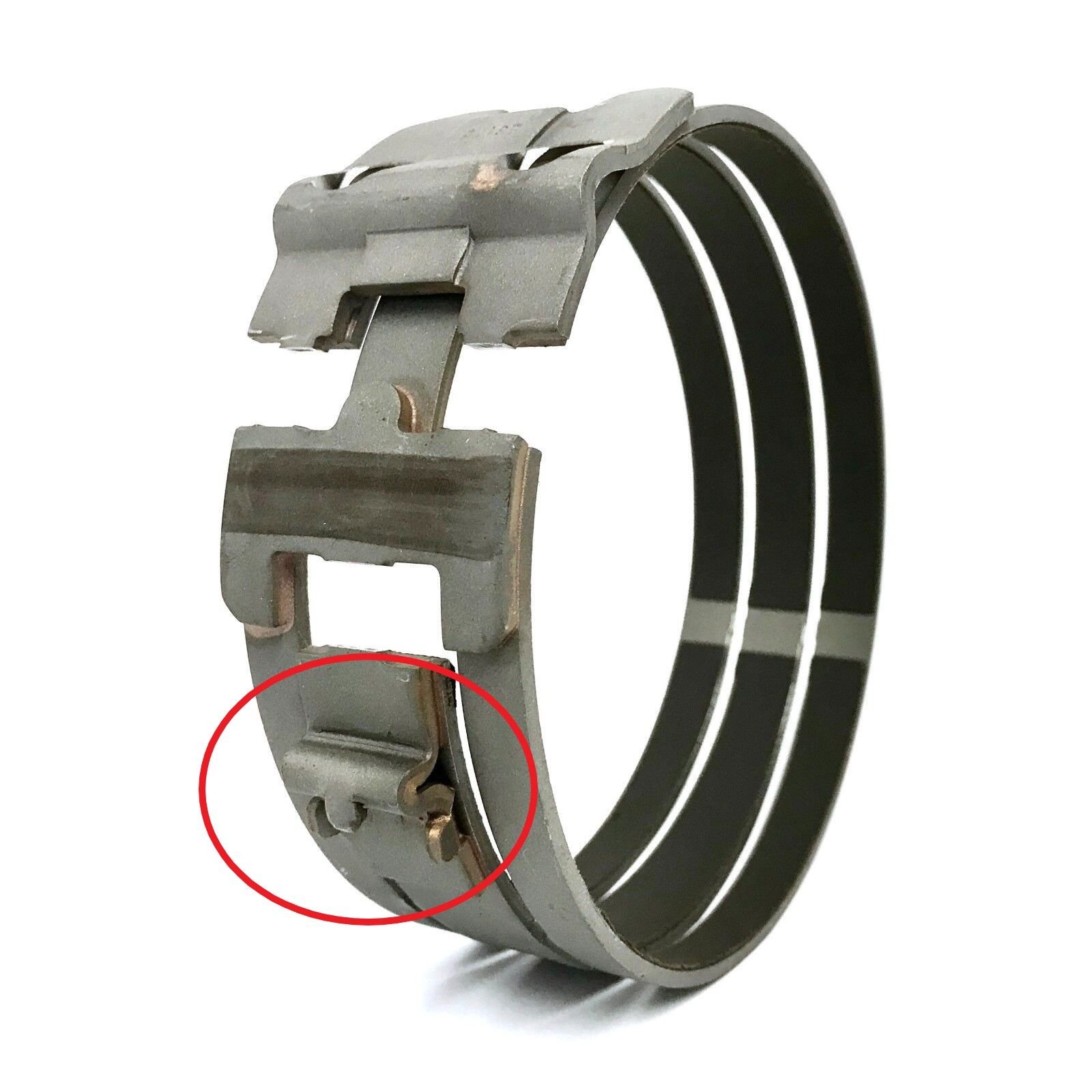

That looks like something from one of the transmission bands. If all forward gears work fine and taking apart the reverse servo doesn't fix your issue, it could be the reverse band. If you look at this image of the reverse band, that piece looks like it came from here. That would prevent the band from being clamped down against the drum to engage reverse. There is no fixing that. Only replacing it. Given the age of the tranny either do a complete rebuild or buy a remanufactured one and install it.

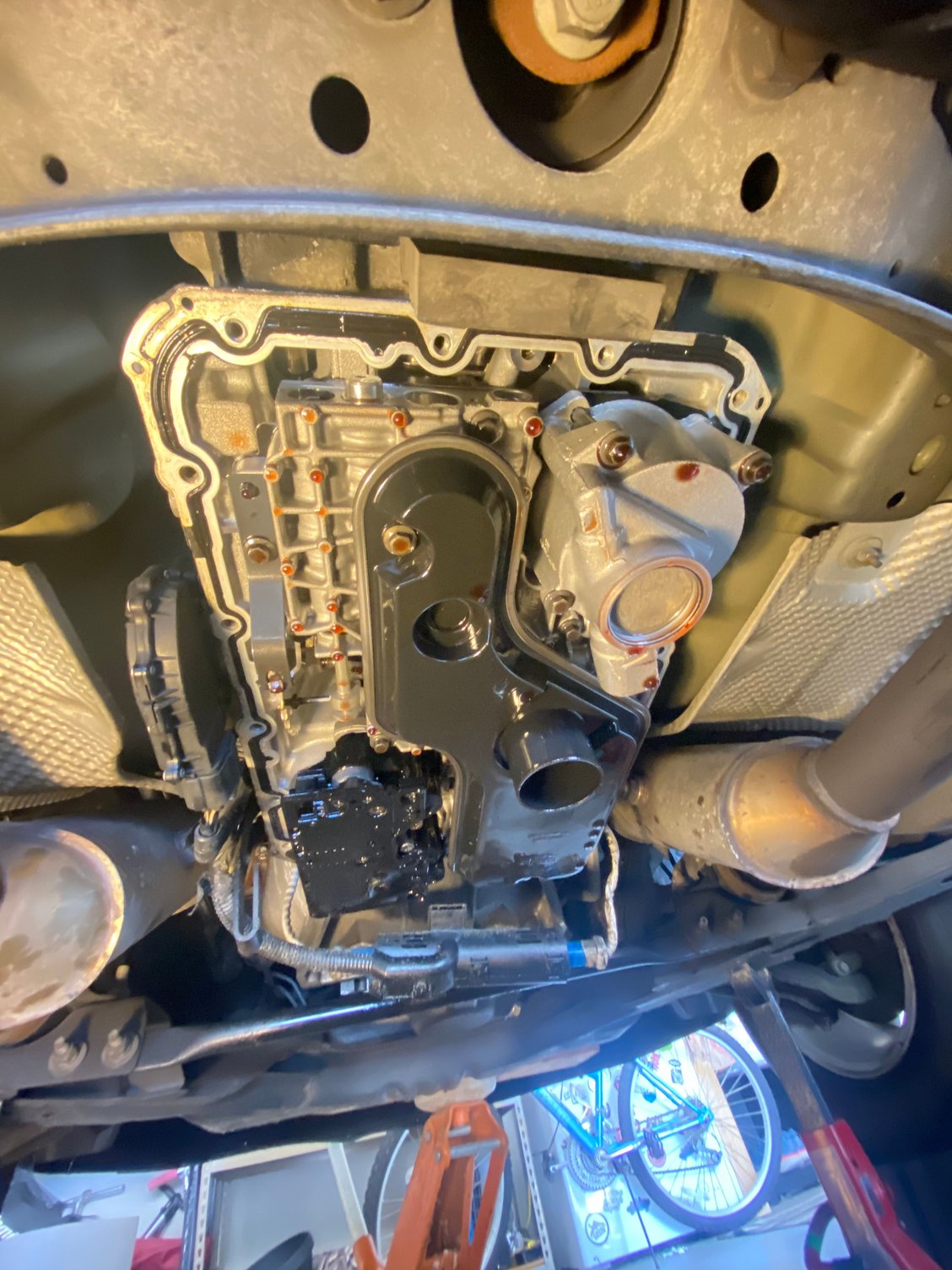

Here’s a look from the rear. Reverse servo located on the right corner, closest to camera

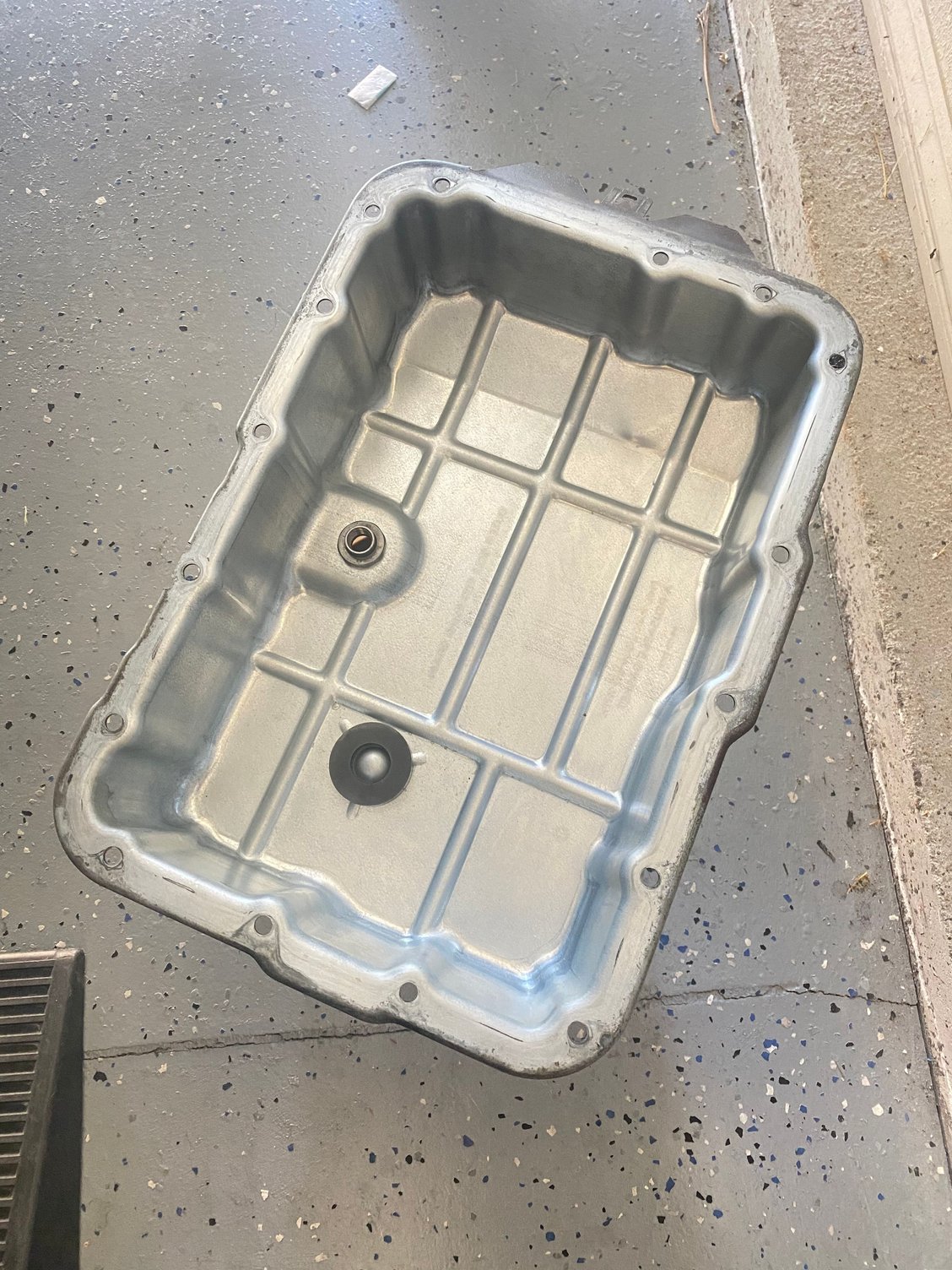

Cleaned out the pan and mating surface.

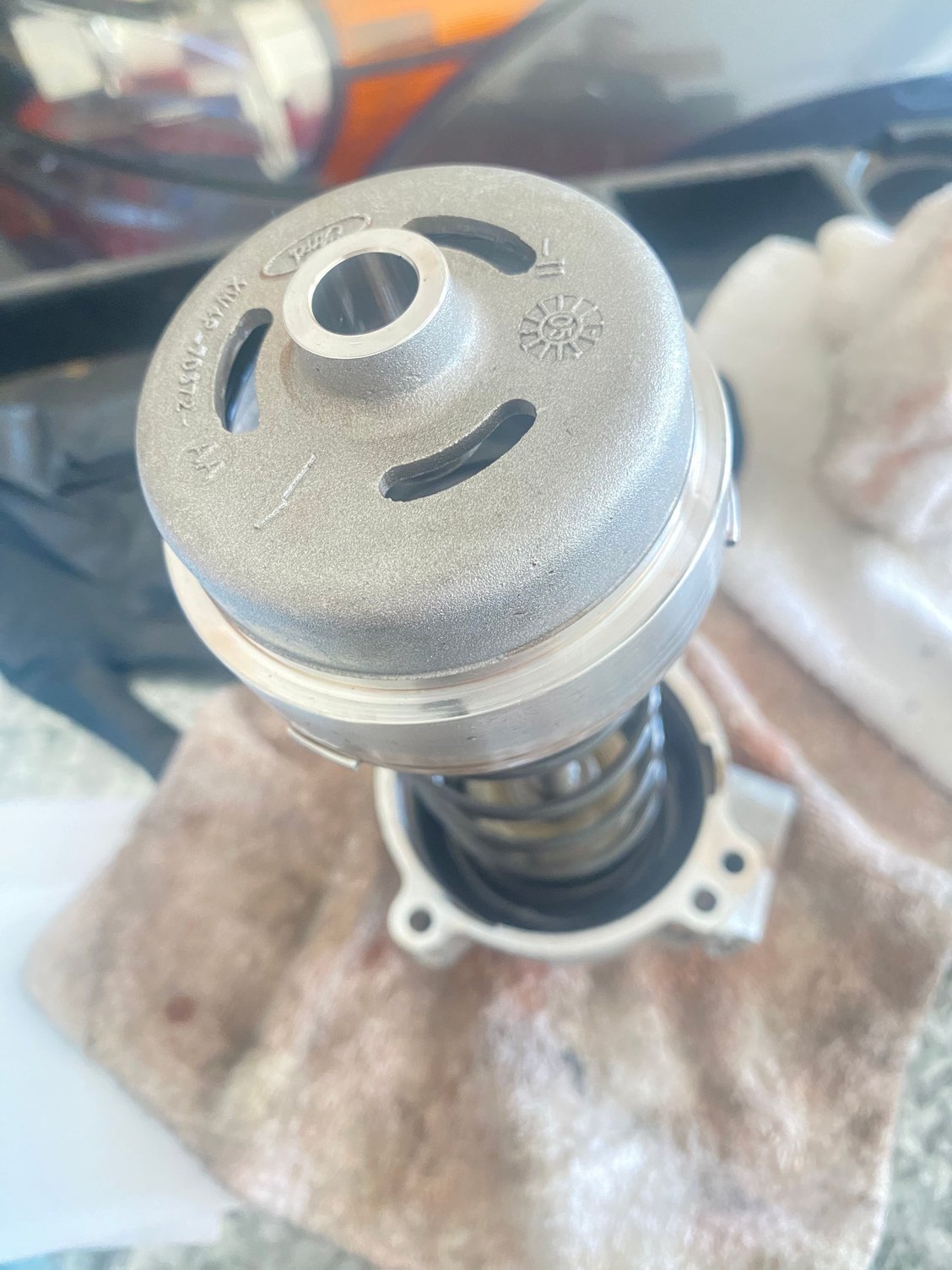

A good twist in either direction will release the spring and open the servo housing assembly.

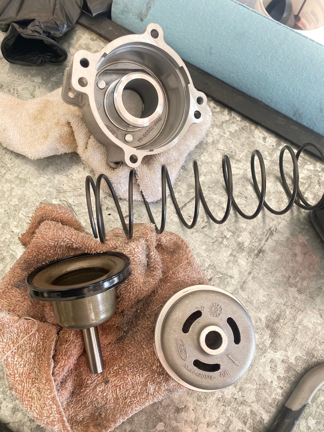

Here are the big reverse servo components after cleaning.

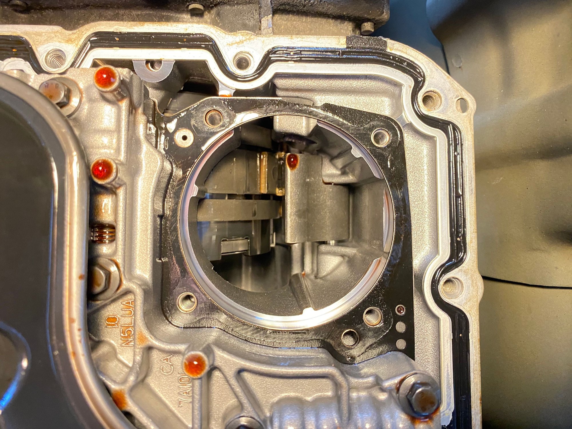

Here’s a look up after removing the reverse servo. I believe that is the reverse band with the other side damaged piece, although it is a mystery to me how the broken piece made its way into the pan—possibly a previous owner who put it in the pan as a “bread crumb” for whoever would try to service in the future. Haha!

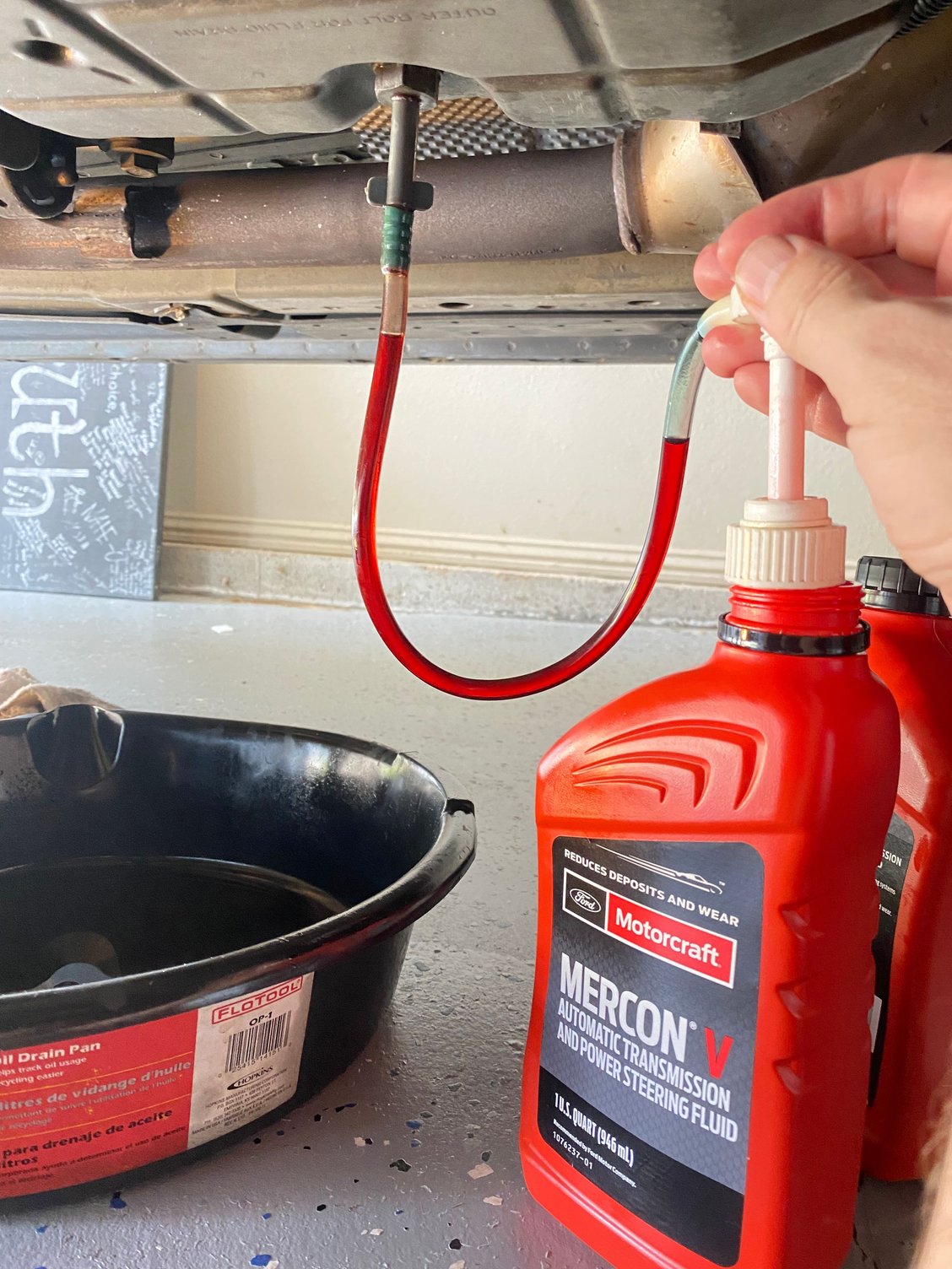

For filling, this is what I made for 2008 (See post 9)
https://mustangforums.com/forum/v6-s...ut-to-die.html
It's a Home Depot bug sprayer and if I recall a 3/8" ID clear hose with a ball valve a nipple on one end a quick release on the other end but, you can use a nipple on both ends. .For the end going into the tranny pan I used a 1/8" to 1/4" adapter bushing and a 1/4" MPT to 3/8 nipple. It was about $25 for parts about 10 years ago. It'll probably be $35 now. Tubing should be long enough so you can have the pump out from under the car.
To use it, I fill it with about 7 quarts of fluid, Keeping the valve turned to off, I pump it up a bit, connect it to the tranny pan adapter, then slowly turn the valve to on. It will probably take about 5.5 to 6 quarts or up to 6.5 if you removed the solenoid pack and valve body.
