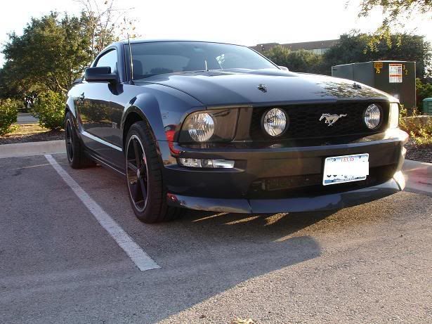

Here are the pics. It's raining tonight so no after pics (except in garage), probably until this weekend.
Before, with Steeda comps all around (as you can see the front is considerably higher by 1/2''):
After with Steeda Ultralites all around (in garage sorry it's raining tonight, no outside pics unfortunately). Ride has been nearly leveled. Front is 27 3/4'' (must have settled a bit over the past 3 days) and rear is exactly 28'':
Steeda comps vs lites:
Orientation of rears:
Rear with lites:
The Steeda comps would be an awesome track spring but were a bit too stiff for my taste on the DD. The ultralites are perfect with the huge hotchkis swaybars I run. I'm planning to sell the comps to someone who either tracks their car or desires that much spring rate. Not for me. The ultralites and hotchkis are the perfect combo of compliance and zero roll for my liking.
