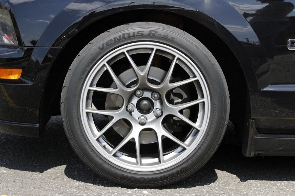

Recently bought some 18x10 BBS wheel from a local Ford Racing Parts dealer. It was a bit of a struggle getting them installed as nobody was really sure whether they would clear without a wheel spacer or limiting steering travel. They are also made for a 5/8" wheel stud and a 45 degree lug seat. In talking to various vendors I found that 1/2" studs would be okay but I still had to get different lug nuts. I then found that the flange on these wheel is thick enough that the stock studs are too short. So in went the lengthened ARP studs sold by Ford.
On my 2006 that originally came with 17" wheels there were no clearance problems whatsoever sitting still. They were a little close on the strut up front so I threw a 1/4" spacer in there for good measure. Looked like plenty of clearance steering-wise.
I'm really happy with the outcome and they're pretty light (20.8 pounds on my scale). Tires are 285/35-18 Hankook RS-3's and believe me I'd get taller sidewalls if I could.
They're a really nice bright silver finish but as you can see the Hawk HP+ brake dust changes that pretty quickly (this is one day of autocross dust). Fortunately the finish seems really nice and I was able to wipe the dust off with my finger after wetting them with soap/water.
