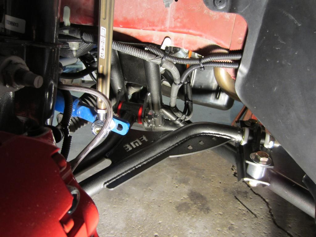

I went with the Shelby Performance Parts front End Links. I am happy with them, but they still are a little difficult to adjust on car. Since I bought them UPR Products have come out with a version using a socket headed cap screw. Would appear to be a little easier to access than the Shelby Links. Anyone have any first hand experience with the UPR End Links?

I'm using the UPR end links on my car. They were super easy to install, and they look nice.
Regarding the OP's suspension choices, I like the Koni Yellows, I prefer UPR control arms, and I'm using UPR's PHB. But Watts Links are nice.
