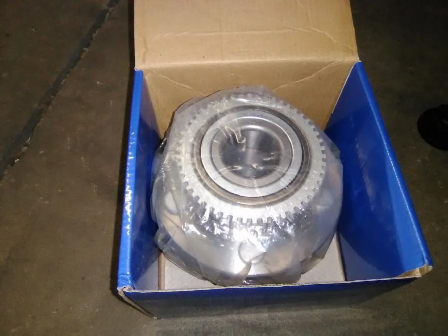

Even though I do not have ABS, the bearings came with the ABS ring on it, and it fit just fine.

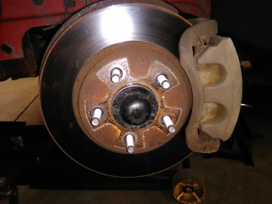

Remove the hub nut cap. Use a flat head screw driver and hamper, and pound the flat tip between the
cap and bearing in between each stud. IT will separate slowly. I have a cap removal tool...

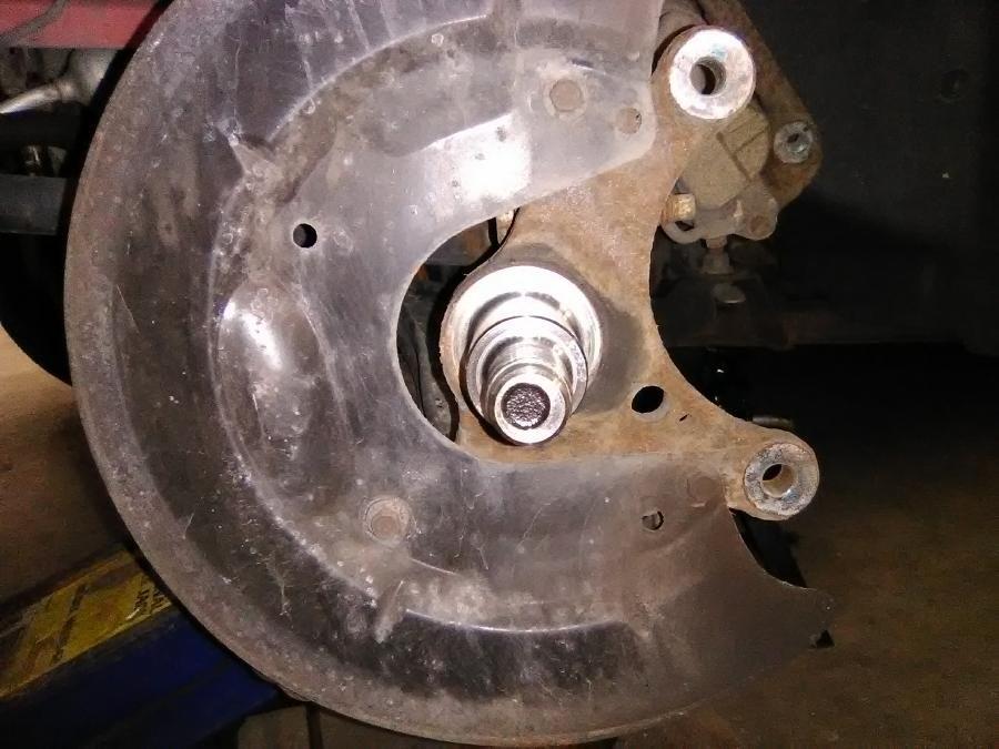

Bearing should slide off when pulled on, you may need to wiggle it some. Mine came right
off, no issues.
Clean the spindle stud, and wire bush any rust at the rear mating surface on the knuckle.
Apply a very thin layer of anti-seize on the stud, and rear mating surface.
Slide the bearing assembly on the the spindle. I may require some wiggling...

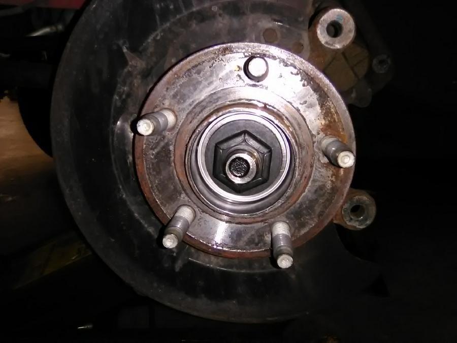

Why you should not use the aftermarket nut:
Aftermarket nuts are a once piece nut, and the whole thing turns as it clamps down on the front bearing race.
This puts friction on the front race as clamping force is applied. This generated heat as you tighten, and can
gall the nut to the bearing race. This also makes them very hard to remove the next time and may need torched
off, and can damage the spindle threads.
Ford nuts are two piece nut that provide increased clamp force while maintaining optimum torque/tension.
The nut spins independently of the collar, thus does not put friction on the front bearing race.

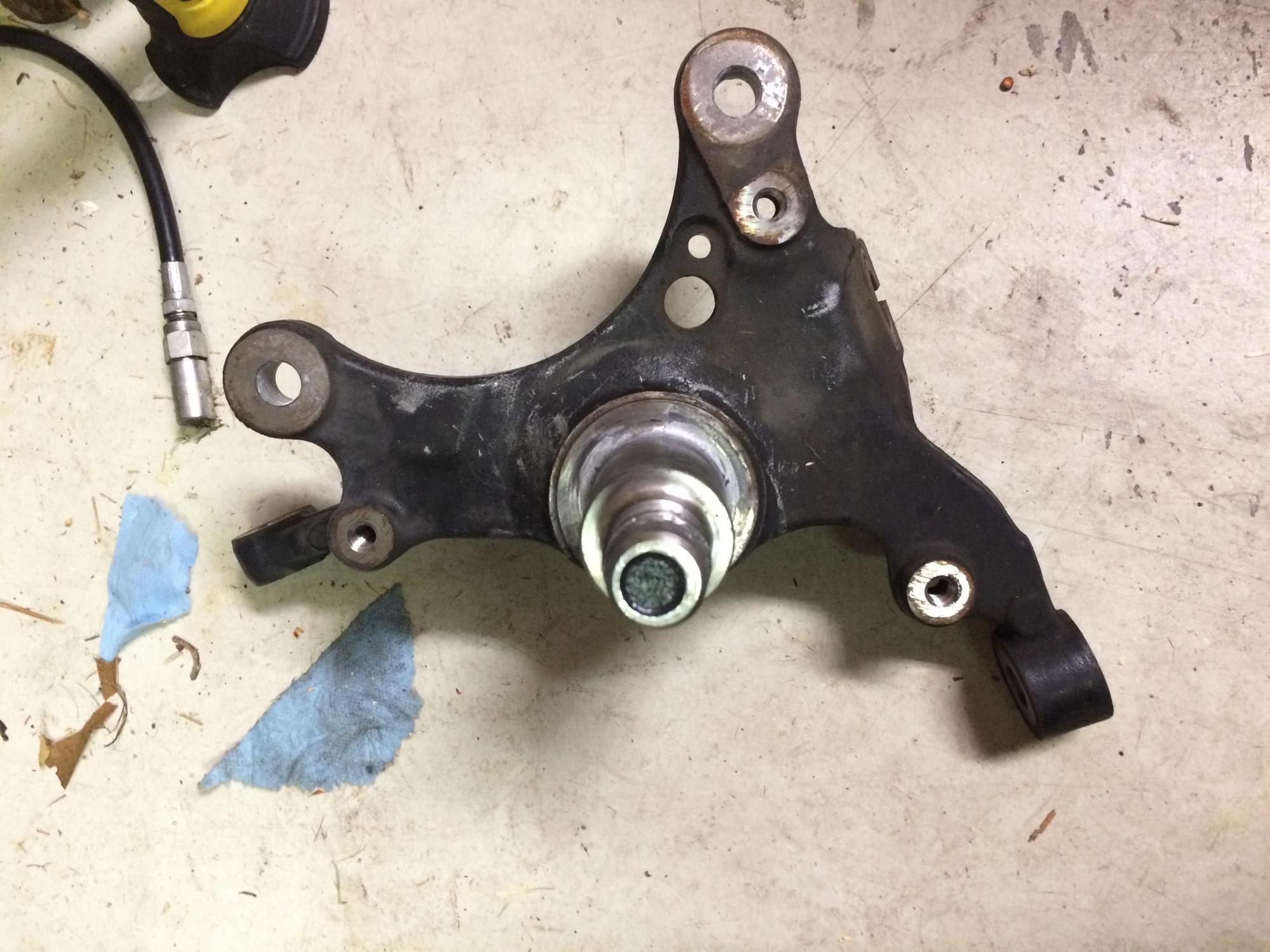

Well, 2 weeks later when I try to remove the aftermarket nut, I find out the REAL reason Ford says don't use a different nut! It took 1/2 hour of hammering on the nut with my impact gun, using heat and lubricant and anything else I could think of to get it off. The metal locking nut is harder than the spindle so it tore the threads up as it came off. So a 1 day job of replacing hubs turned into finding a good used knuckle/spindle, replacing the knuckle, which also prompted replacing the outer tie rod ends (they were looking worse for the wear), and a trip to the alignment shop.

6. Damaged Spindle threads.
