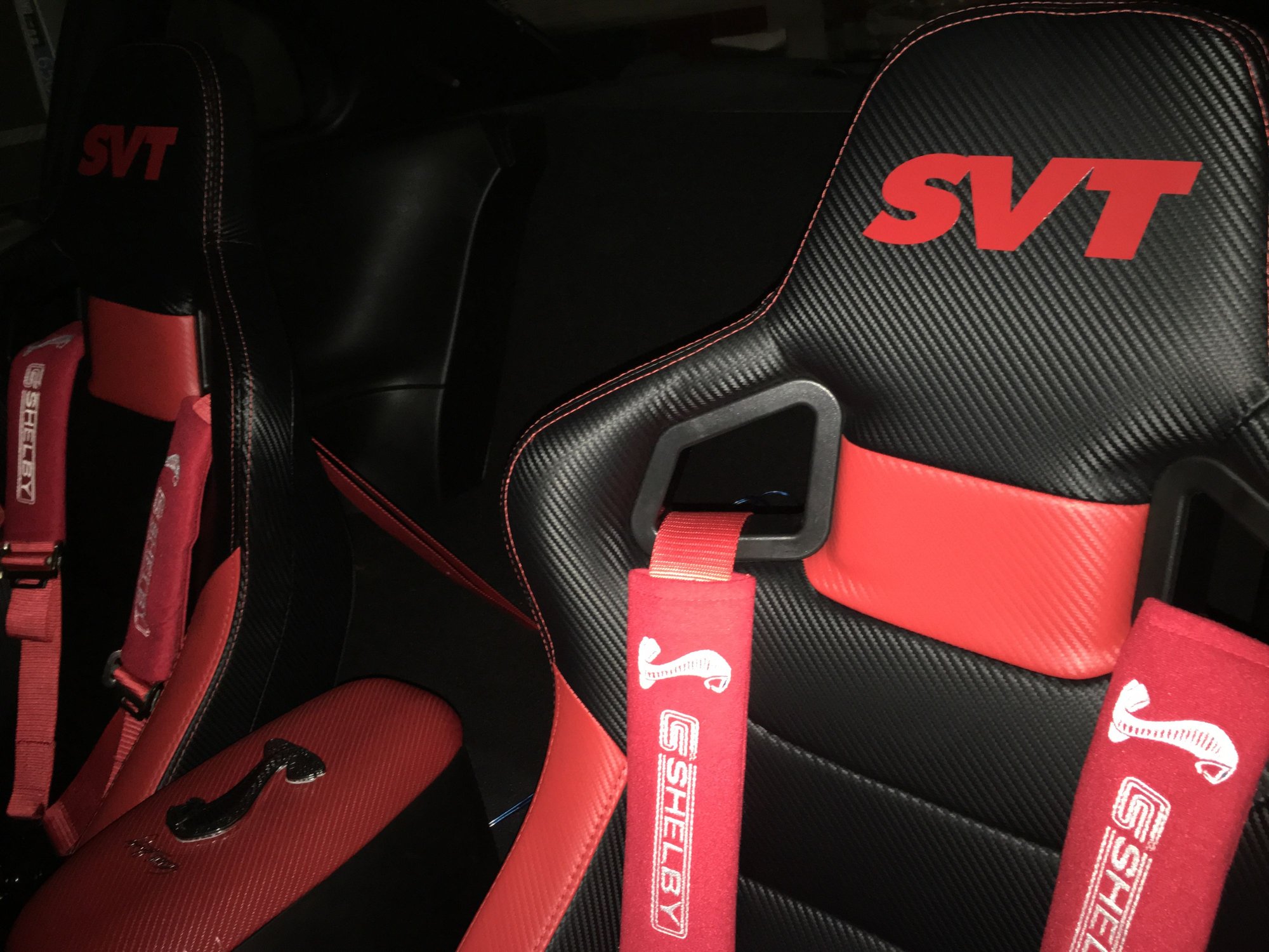

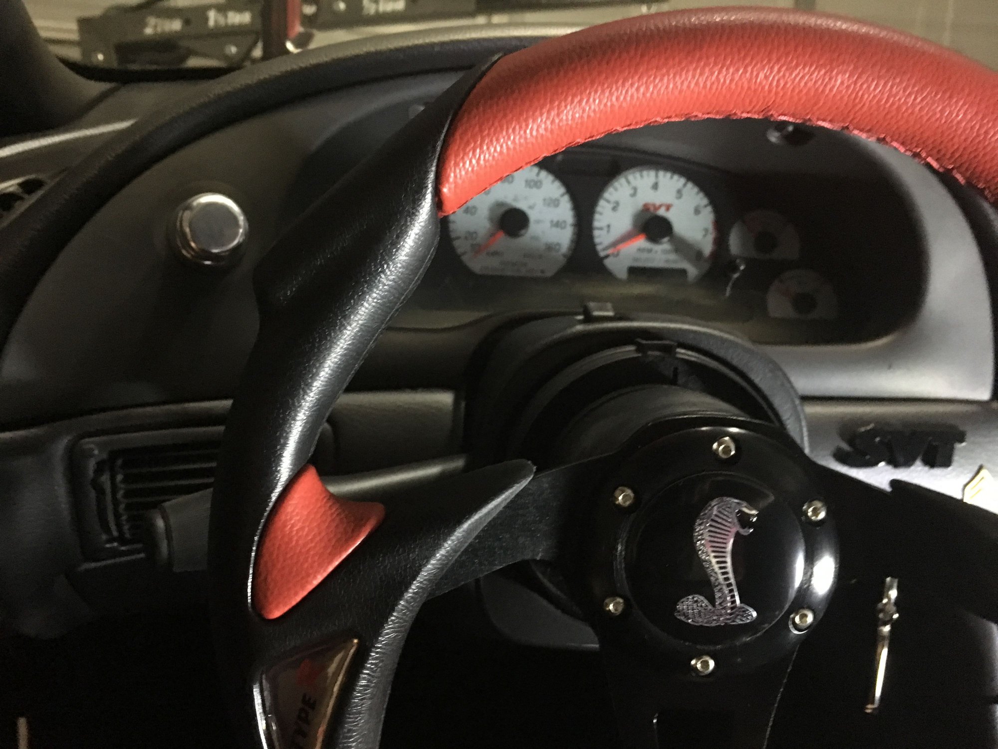

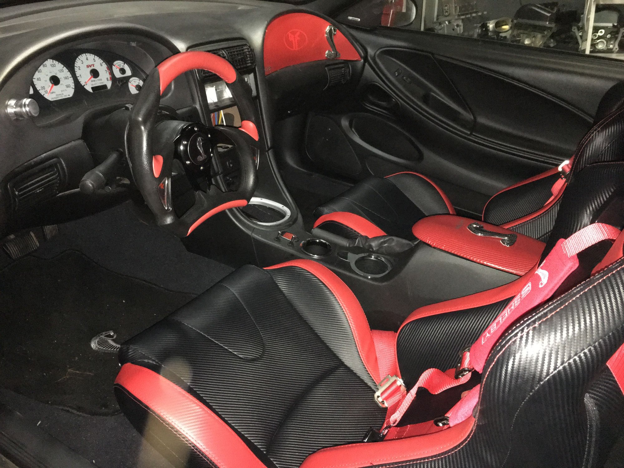

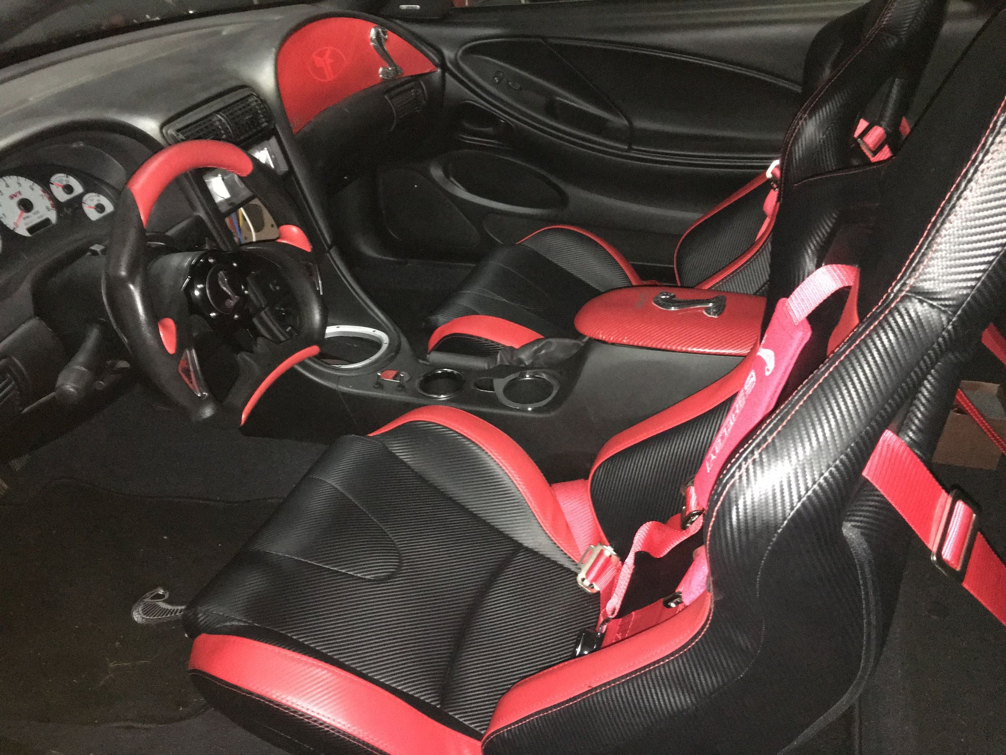

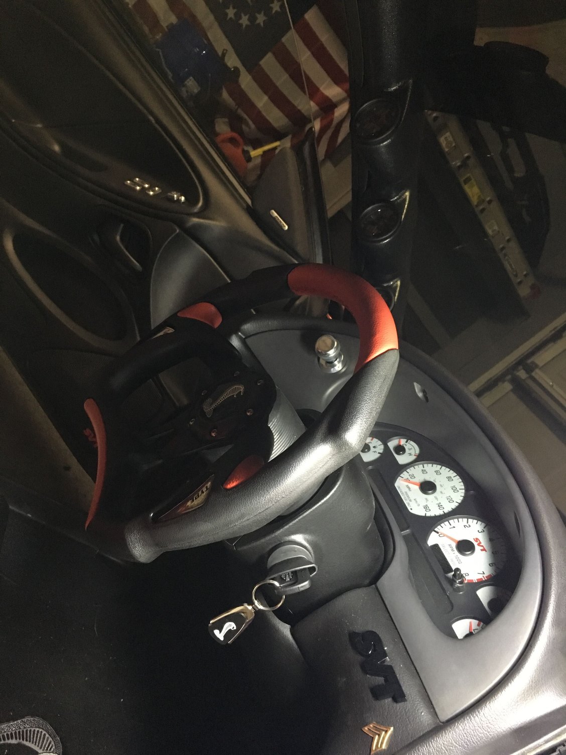

Radio is installed and interior is 96% complete. Only thing left is headliner to black instead of grey. And sun visors to pvc black with red stitch. I ordered the clutch pedal assembly to begin the conversion from automatic to manual.

Looks great!

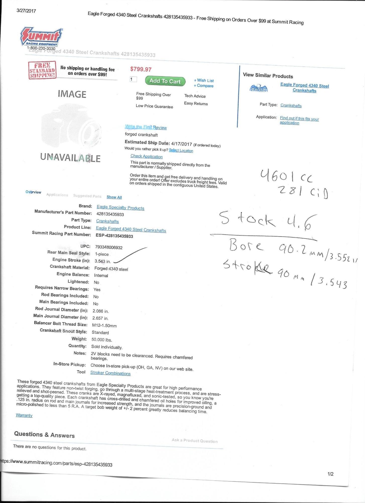

Ordered forged crank, Tires and new front suspension! many more to come!!
