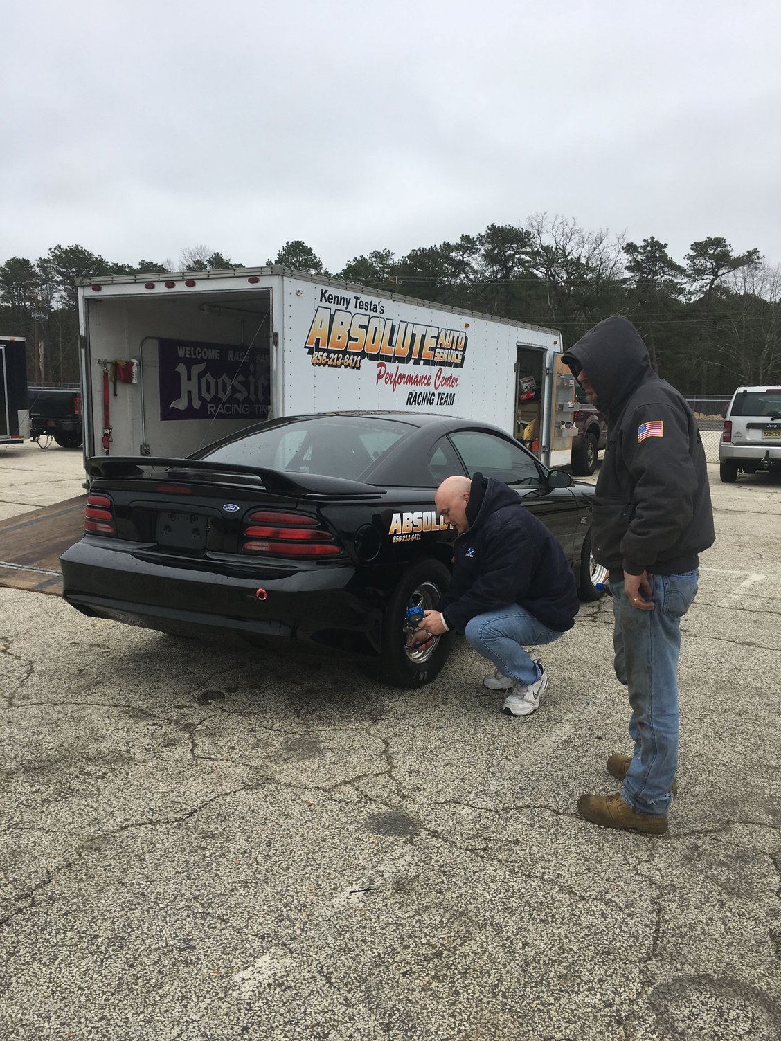

We took some major steps to keeping her out of the wall last week. We scaled all four corners of the car and set the suspension. It's with in 4 pounds of perfect weight on three corners. And 8 on the back corner. She should run straight on the first pass but we'll make the first pass a 2500rpm foot brake pass. If all goes well. we'll load up the transbrake and try a 5 grand launch.

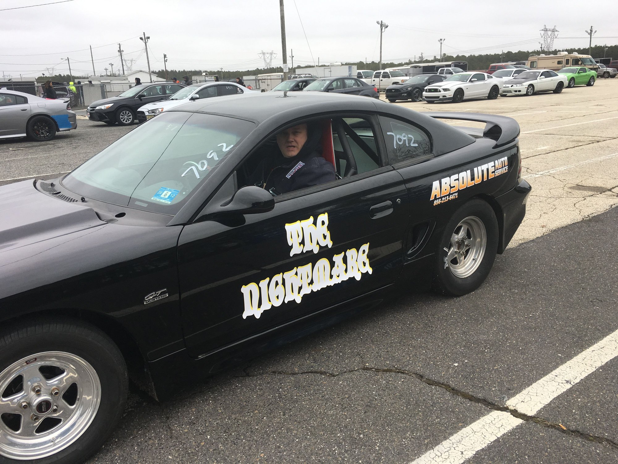

3/26 first test & tune.
First pass. We left very conservatively off of the foot brake at 2000RPMs. Air pressure in the slicks was 12psi. 11.7@114 with a 1.7 sixty foot. Car went straight as an arrow! Glad that one was over!
Second conservative run. Left at 3000RPMs off of the foot brake. 1.7 sixty, 11.7 again.
3rd pass we let it rip off the line. Trans brake launch. 5500RPMs. lowered the air pressure in the slicks to 10psi. 1.308 sixty foot. 11.5@116. Get the car back to the trailer and notice that the gas peddle was fetching up. And apon farther inspection. The throttle cable wasn't adjusted properly. We were only running on about 50-60% throttle. Pretty impressive that the car was trapping 114-116 at half throttle!
They then shut the track down due to rain. Never got to run it again after we made a sizeable throttle cable adjustment. So all in all. We gathered some good data and made a few repairs. I don't want to say. I was disappointed. Because I expected a million adjustments the first time out. But wow a 1.3 sixty is like being shot out of a cannon.
Next outing should get some serious numbers.
