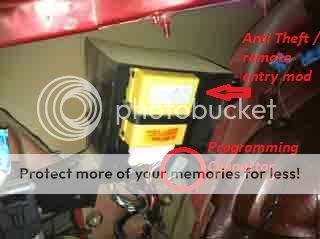

holy thread resurrection batman...had to do this because I just found the keyless remote module in my 94 today as had to take the trunk carpet and trim pieces out to remove the taillights. Now, on ebay they have remotes and the instructions say to jump the two pins on the plug that is attached to the remote module to enter the programming mode and then just push a button on the remote to program the system. Has anyone actually programmed a remote this way? I have read tons of posts on here about this and some say the dealer has to do it ($90-$100), or you turn the key on off 8 times, etc, etc....so anyone used the plug in the trunk to program a remote?

Yes I did this the other day for my 98. The whole process takes about 5 minutes.
I do want to clear up one thing. This process is commonly referred to as programming remotes. And that's fine. But what is actually happening is you are storing the remote transmitter's ID coed in the cars system. Once the car is in "programming mode" each remote is pressed and it transmits it's ID code. The car then stores that in memory. The memory can hold up to 4 codes. Once the process is complete only remotes that match a stored code will work with the car.
This is the best site I have found for this: http://www.programyourremote.com/
here is a pick of the connector and module:

What makes you believe the module is not in the trunk?
The Factory "Electrical Vacuum And Trouble Shooting" manual page 151-14 shows the Remote/Keyless Entry Module mounted in the trunks on the drivers side. And when I was programming my remotes I saw it there.
This system can include PATS, Anti-theft and remote entry. My 97 only had PATS, no alarm system and no keyless entry.
The 98 has all 3. The PATS receiver is in the steering column and the PATS Control Module is in the instrument/dash panel. The anti/theft and remote entry modules are in the trunk.
According to Ford parts drawings, a car could come with Anti-theft, remote entry or both. As far as I can tell all cars came with PATS (96 on).
