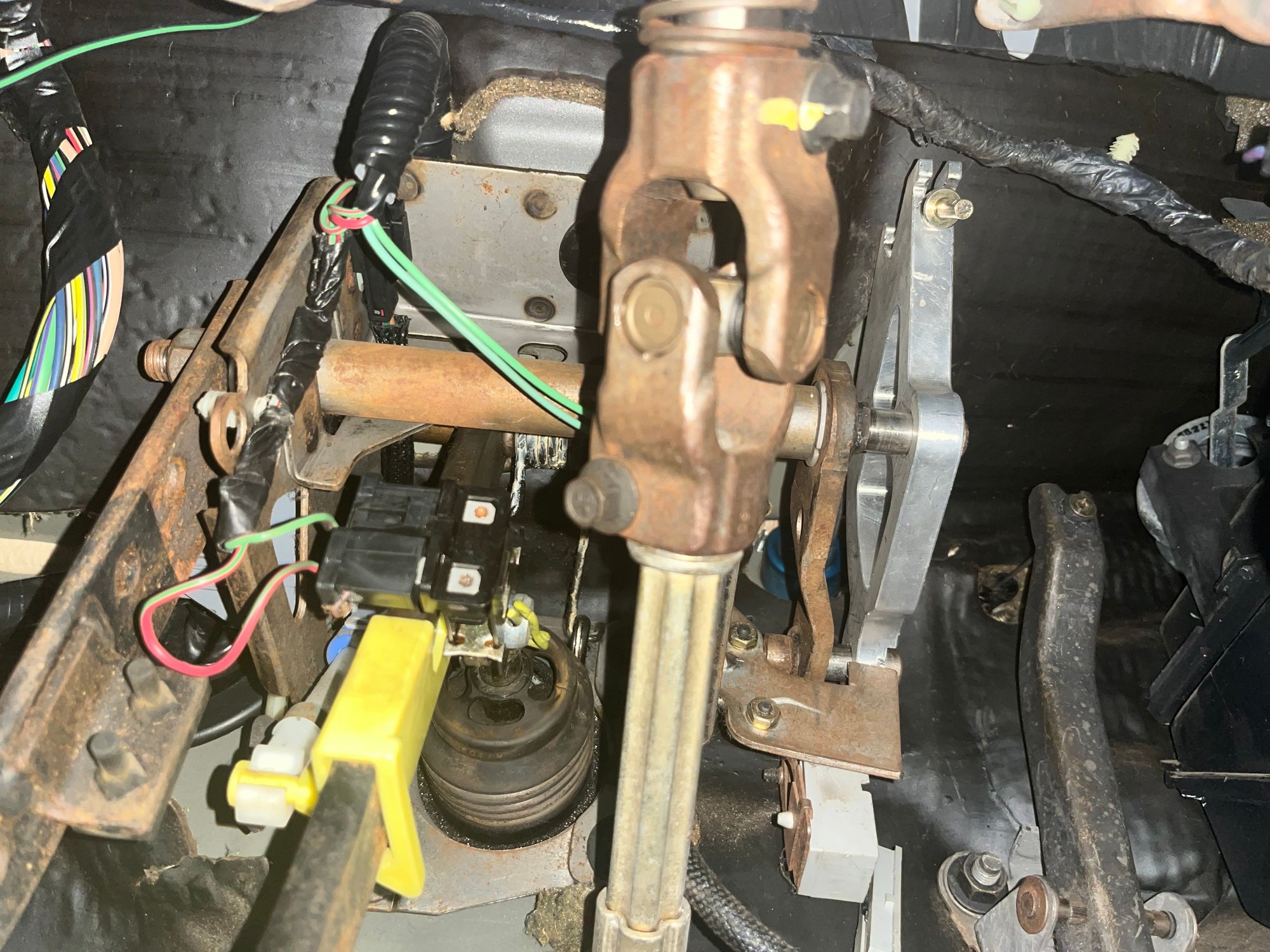

Default 2000 3.8 v6 no clutch
I just bought a 2000 v6 5 speed , was told the transmission was blown and lots of tranny fluid leaked out, with the vehicle off, the transmission shifts into every gear smooth, running the car won’t go into any gear, with a pair of vise grips on the clutch cable holding it in the quadrant I tried to push the clutch and it was hard as a rock, no movement
