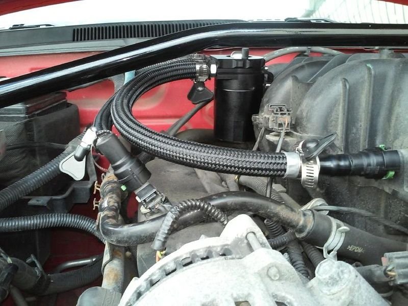

REVISED, Waiting for the black braided stainless hose to come in!
Still have the red one hooked up till I get this done. Maybe use BOTH? Hmmm.....

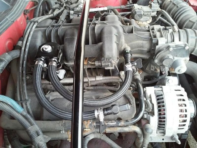

Finished it today!

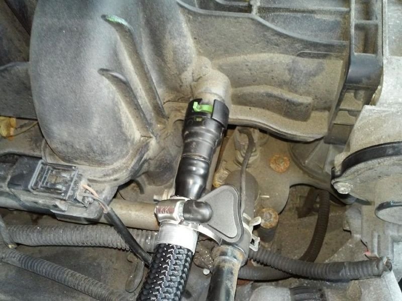

Measuring hoses and checking for kinks and such:

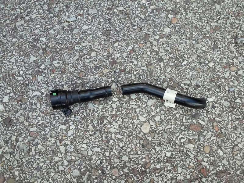

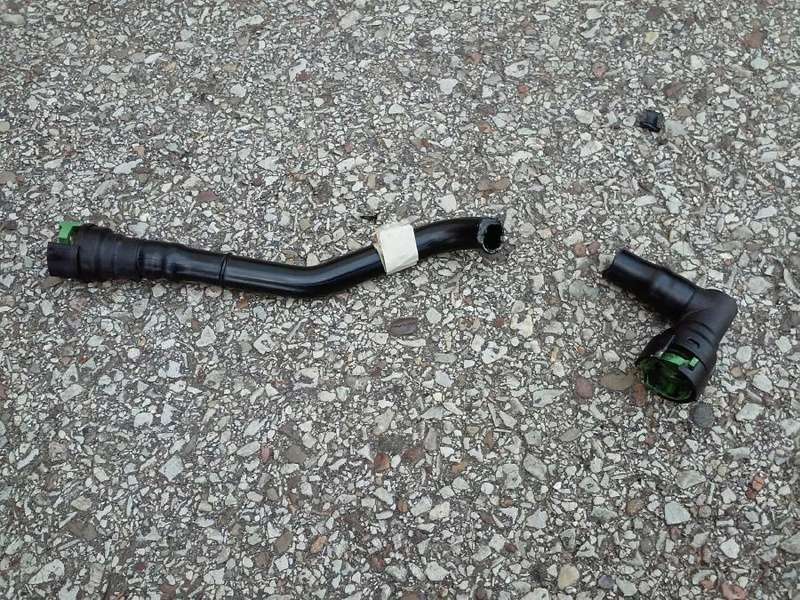

Cut my original PCV hard line to make quick disconnects for the braided hose:
Put the quick disconnects on the hoses:
ALL DONE:

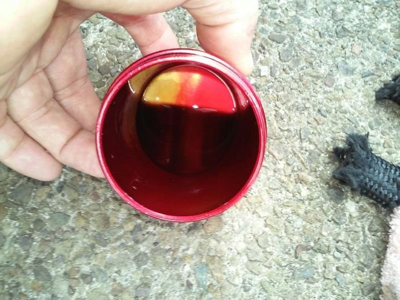

This was what was in the other one ~2000 miles:
10AN Braided line was just under $3.00 a foot on eBay.
Catch can was $24.00 on eBay, and is baffled for steel wool. The baffle is about 1.5" in
diameter. It unscrews and you have about a .5" of height to put the material in.
The black one, they sent me a new kit for free when the bracket broke on the red one.

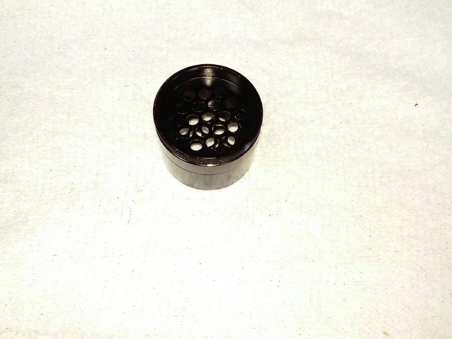

How to properly baffle the catch can:
I order catch cans with removable baffles, and they are empty when you get them:
Stainless Mesh:
Baffle opened:
Stuff some mesh into the baffle:
Close it back up:
This baffle screws into the top of the catch can:
The stainless mesh helps to better separate the oil, so more of it is removed from the vapors.
The issue with some cheap catch cans, is that they position both the inlet and outlet ports too close
together and with no separation inside, leads to a fairly useless setup when it comes to separating
oil and vapors. Make sure it has a baffle!
ALL DONE:

Well, there I have shown you, ~2000 miles, and just about a table-spoon of oil in there, so
that's just fine. Per Ford, oil consumption of 1qt per 1,000 miles is normal. It says in your owners
manual to check the oil on a regular basis, just like it does for any Ford vehicle.

If you are not leaking it, you're burning it. Most of that will be through the PCV system.
ALL cars with PCV systems will have oil vapors burned through the intake, that's
what it's for, and for relief of crank case pressure. The catch can helps take the oil out
of the vapor for a cleaner system and emissions. That amount I have in there for ~2000
miles is not a lot at all. It would be almost full at 10,000 miles, and that's how it has
been for all my cars, with one exception.
I had a VW TDI, and the catch can would fill up almost two times between oil changes.
That was still not high, and I'd rather it go into a catch can than the inter-cooler and intake.
