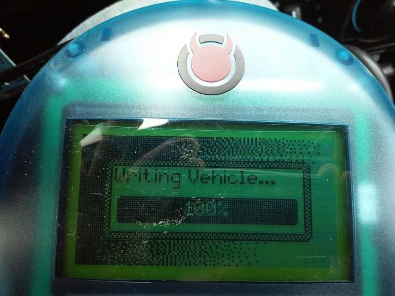

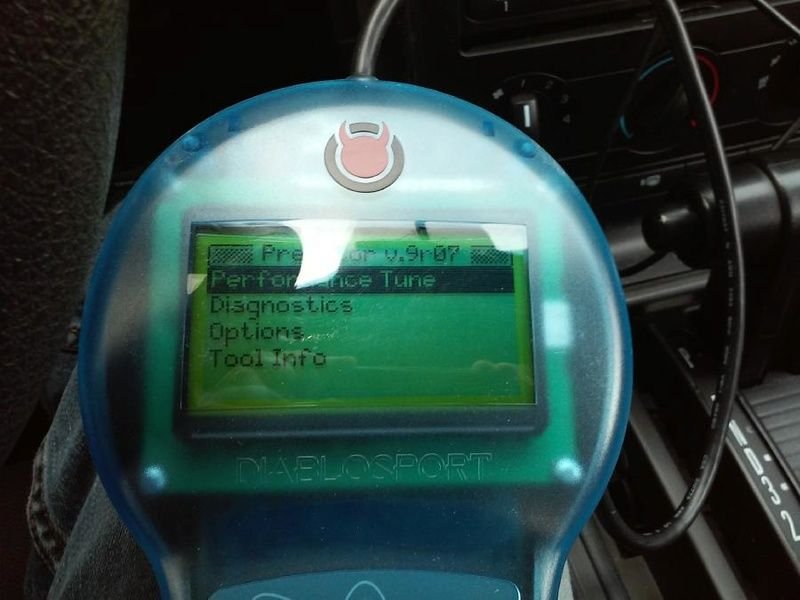

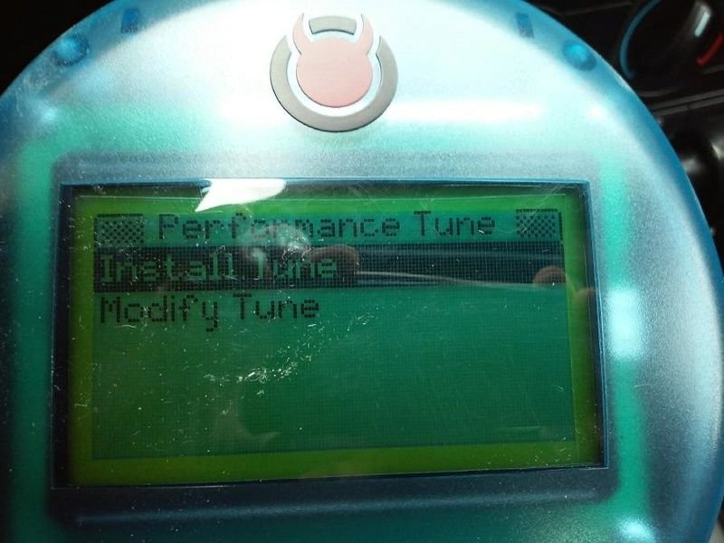

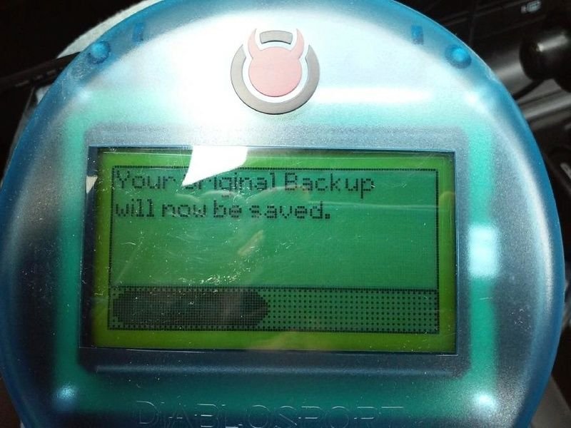

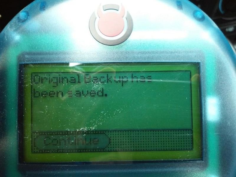

Got a tuner for $137.00, from Canada, the Predator U7154:
'Bout 2-minutes pass...
Few minutes pass.....
Done!
A:F ratio hasn't ever gone above 14.08:1, after the tune, it went to 15:1 with a short run at WOT.
Will see what the MPG increase is this week, starting tomorrow.

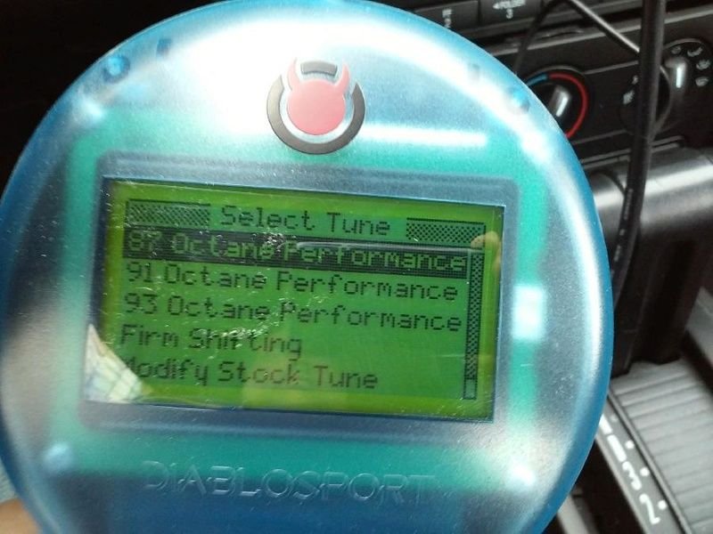

I also tried the 87 and 93 performance tunes. Believe it or not, the 93 didn't have
a reduction in MPG as long as you weren't stomping on the pedal. Both of them
lost MPG when cruising at 80. If Kept it to about 70 and under, they faired pretty
pretty well. Though, I really didn't notice the HP increase with the 87, but I did with
the 93.
I am not going to keep it on 93, because even though the MPG is fine, I am not
paying the price for 93 octane fuel...
Also used the firm transmission shift option, and yeah, THAT'S the way they should be!
