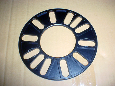

Finally i thought you might like to see the spacers that were on the back after i cleaned them up and sprayed them. They are 5mm thick and there was two on each of the rear hubs making it a 10mm spacer altogether.
