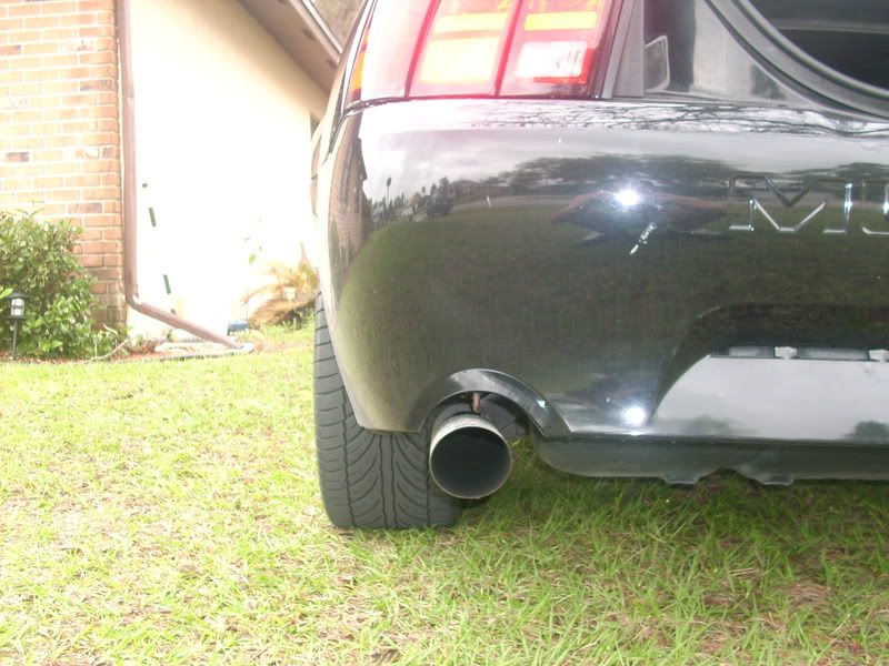

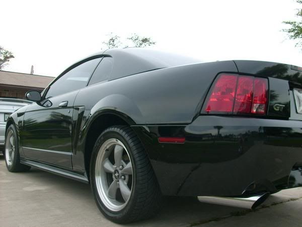

i have ran a 275 on my 8'' wide rims for 3 years.. no problemos

Got any pics of what it looks like?

You can run a 275 Nitto drag radial (they run smaller than most) on stock rims with no issues. They really don't bulge out that bad.
Technically you're no suppose to, but i have 2 friends that have been doing this for many years.
