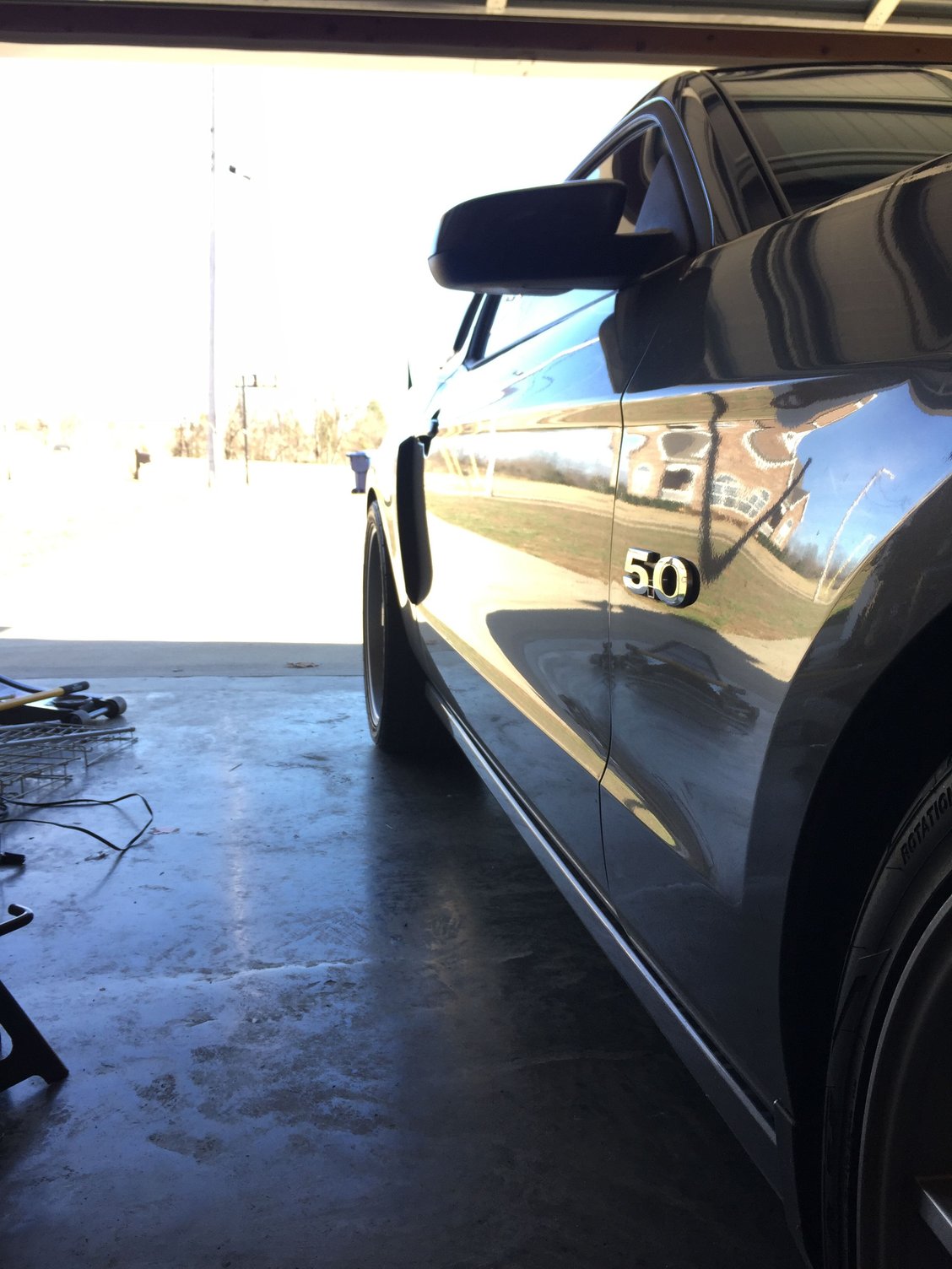

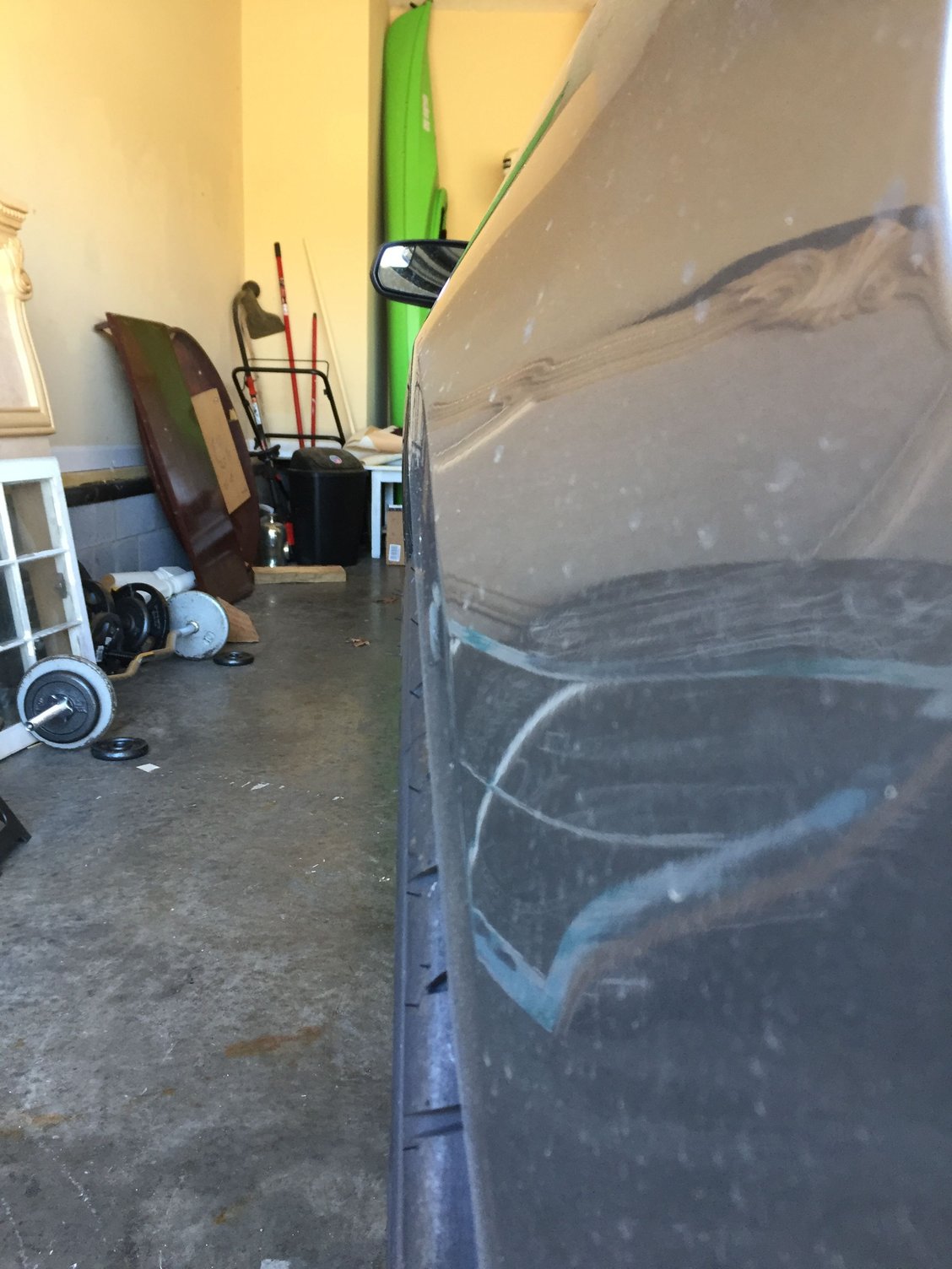

What are the offsets on the wheels you are looking at? Offsets, rim size, and tire size will all factor in with each other when looking for the flushed look. Thats what you are looking for.
I have a 305/30 20x10 +45 offset rear and a 255/35 20x8.5 +35 offset front. My rear is pretty much flushed with the fender as where my front kind of sink in the fender if that makes sense.
