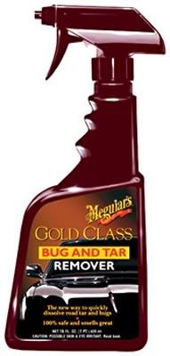

I use Bug and tar remover for adhesive left on from emblems.
Thanks, I'll give it a shot...
