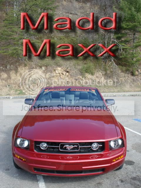

I've been cutting and installing vinyl for the last 4 years and a windshield banner can be a big challenge on a curved windshield. If you don't have the decal cut with a slight arch to match the curve of the windshield it can look as if the decal has a big frown......both ends can taper down from the center. The crazy horse decal on my windshield is right around 4x42 with a slight arch precut into it to make the install a little easier (just kind of a PITA to get straight)
Soapy water will be a big help to install that 8x30 decal. Dawn dish soap seems to work as a homebrew application fluid.....just don't use to much soap in your mix (a few drops to a quart spray bottle is enough).
