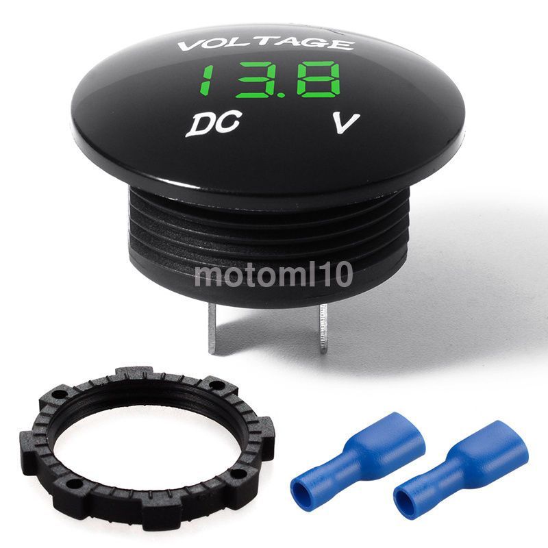

PRODUCT, Mine is in RED:

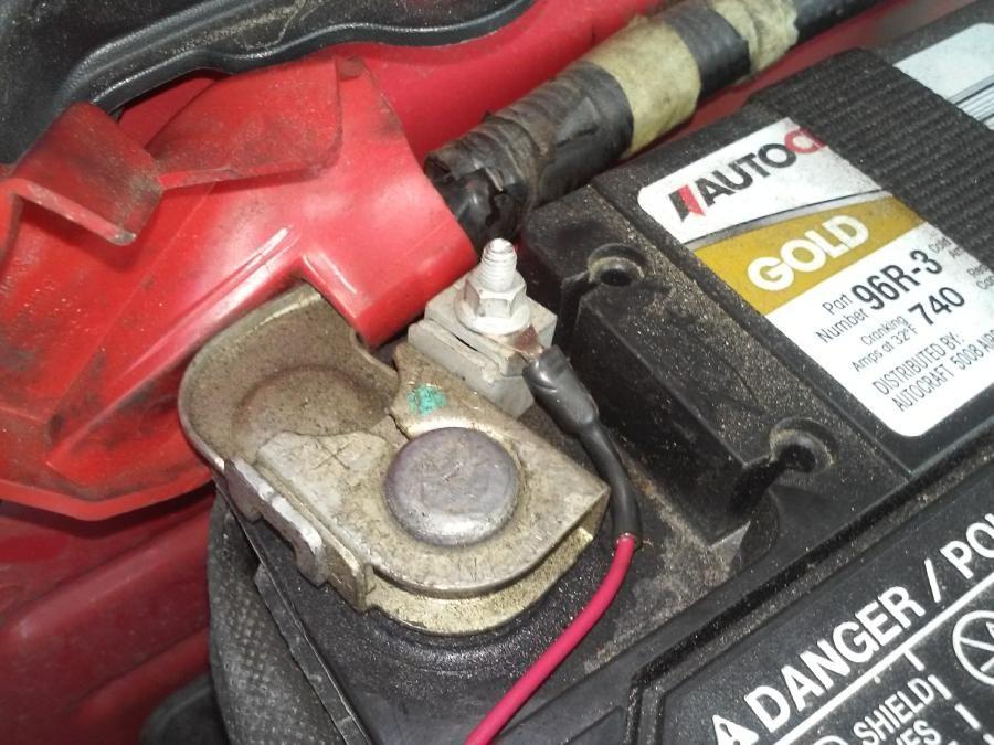

Battery connection to Pin 87 Relay:

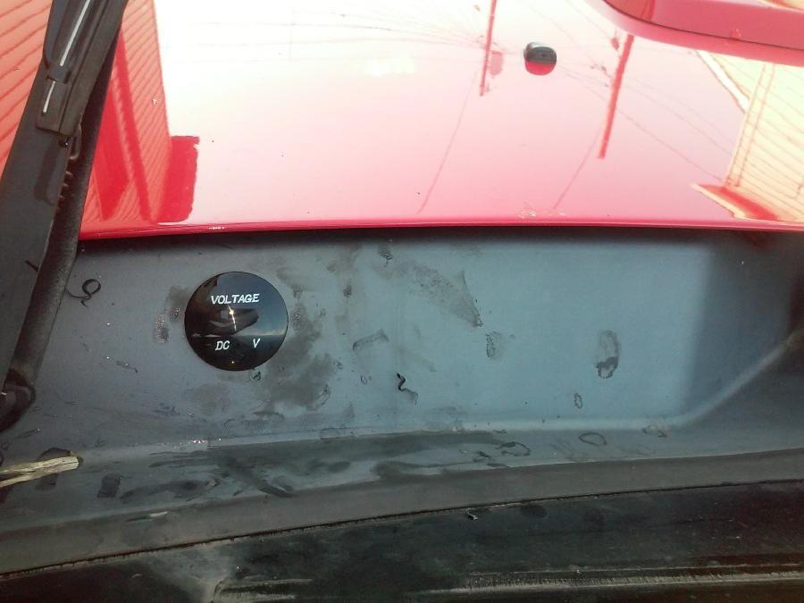

Volt Meter Mounted:
Yeah, I wanted it farther right, and up to the top. I was just not paying attention, and drilled where it is...

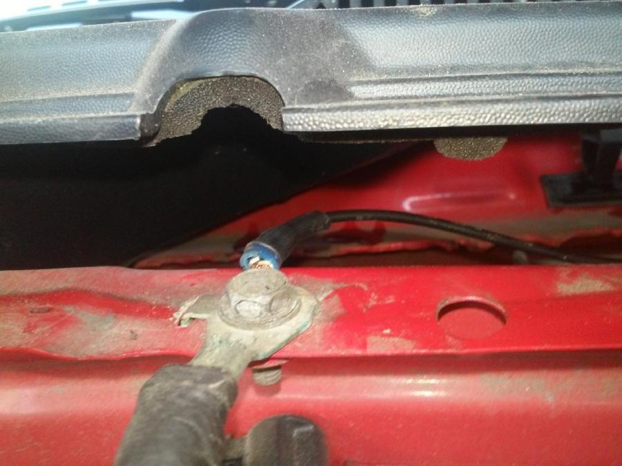

Meter Grounded:

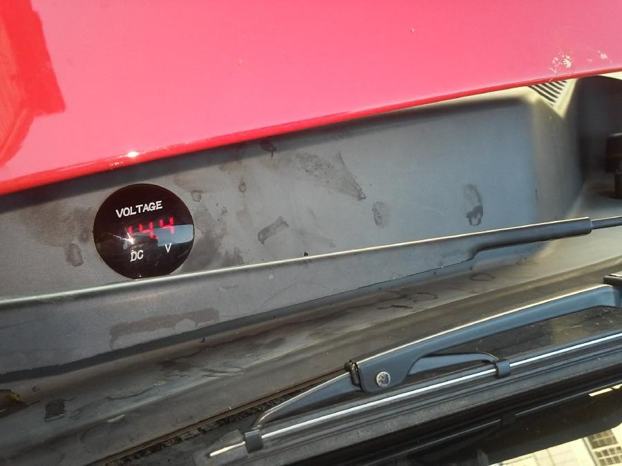

Ignition On, Motor Off:

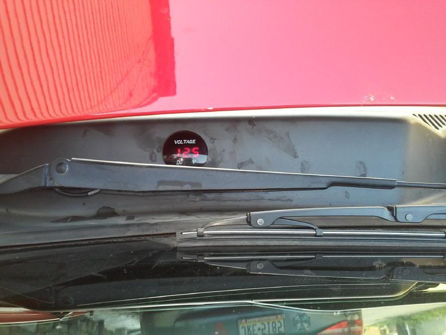

Motor Running:
Hood Closed, Motor Running:

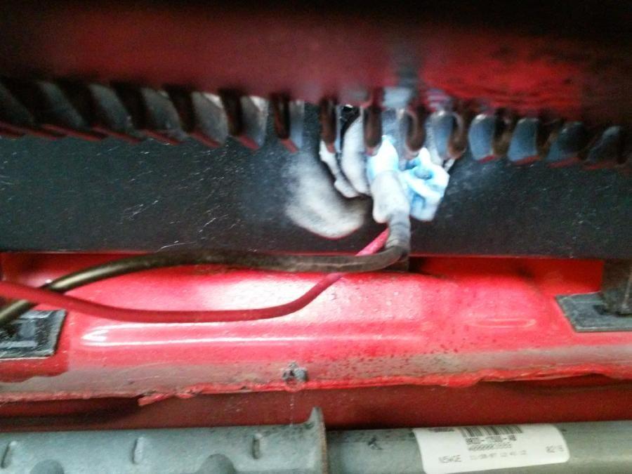

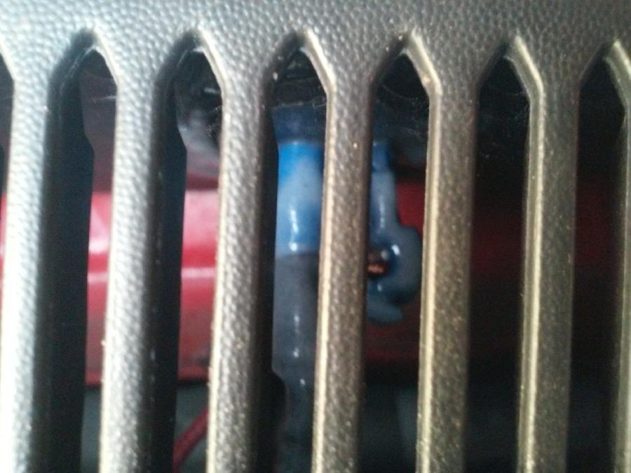

Time to seal up the wires at the volt meter:
