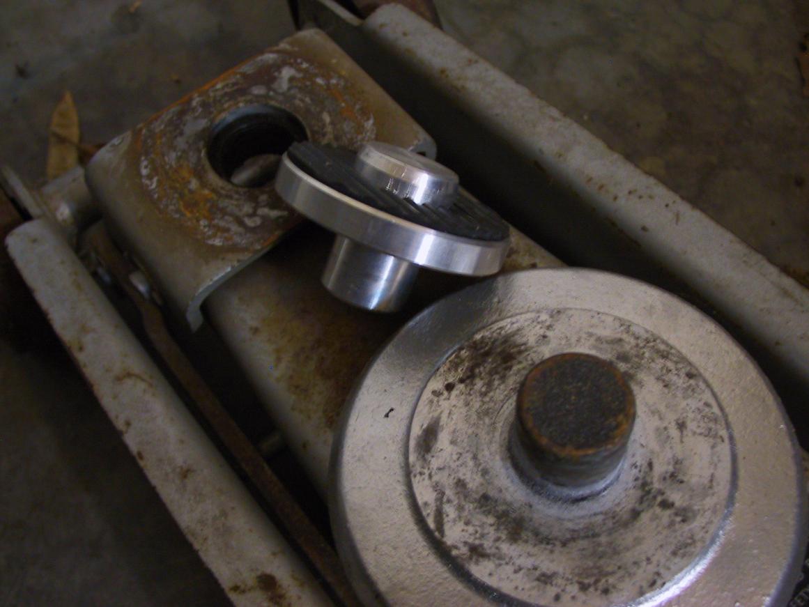

Dont be lazy, do it one side at a time.
Its not NASCAR here. Safety first.
I use the hole in the sub frame.
I removed the platten from the floor jack and
replaced it with a turned aluminum piece that fits
into the stud mount on the jack and fits into
the hole on the subframe. I have a thick
rubber pad on top of the aluminum piece.
No slipping or scratching.
Mucho better than the pinch weld method.
Agreed. This is the spot that I was trying to explain earlier and could not get a picture of myself.

The easiest way to get the car up would seem to be to howarmat's illustrated method. My car isn't lowered so I should easily have enough room to pump the jack up.
One concern. My jack doesn't have any rubber piece on the cup. Is metal to metal contact there a no-no?
