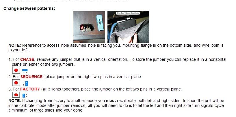

The jumper is on the module, it is a small blue plastic piece that can be set in a few different ways.
Change between patterns:
NOTE: Reference to access hole assumes hole is facing you, mounting flange is on the bottom side, and wire loom is to your left.
1. For CHASE, remove any jumper that is in a vertical orientation. To store the jumper you can replace it in a horizontal plane on either of the two jumpers.
2. For SEQUENCE, place jumper on the right two pins in a vertical plane.
3. For FACTORY (all 3 lights together), place the jumper on the left two pins in a vertical plane.
NOTE: If changing from factory to another mode you must recalibrate both left and right sides. In short the unit will be in the calibrate mode after jumper removal, all you will need to do is to let the left and then right side turn signals cycle a minimum of three times and your done

So that is under the driver side?
If you are referring to the picture above yes the module is on the driver side.
It's on the driver's side; in the trunk. Remove one bolt and pull the molded carpet away from the quarter panel to reveal the control box.
