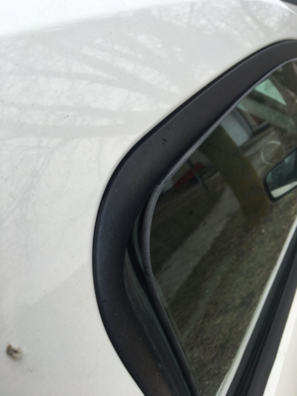

Old Mar 12, 2018 | 11:07 AM
Anime187's Avatar
Anime187
Joined: Mar 2018
Posts: 6
From: Ohio
Old Mar 12, 2018 | 01:34 PM
Derf00's Avatar
Derf00
Gentleman's Relish
Posts: 13,189
Looks like the window track is out of alignment or one or more guides has broken. As the track nears the top of its travel it's not holding against the rail like it should so it allows the glass to to pop out.
You'd have to take the inner door panel out to inspect the track/rail assembly.

Old Mar 19, 2018 | 08:27 AM
Anime187's Avatar
Anime187
Joined: Mar 2018
Posts: 6
From: Ohio
Ok finally had time to tear into and found out that it needs a new regulator. The back side that holds to the track is broke off.
