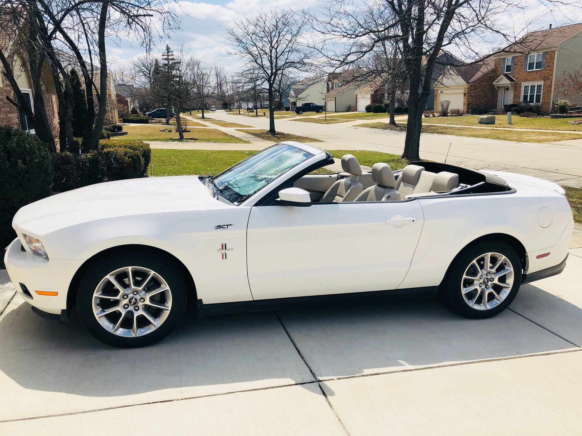

I would love more feedback from yaall, if you have any other logical reasons please through at me. Thanks... In the meanwhile, I wanted to share a PIC of my Pony with yaall.....
